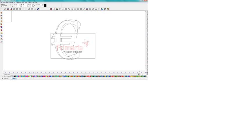

why does Signlab 8 do this?
gabagoo
I have seen this before especially when importing eps files... this file was a .ps but seems to import as either an eps or an ai, but it has these 2 letters jammed in and somehow connected to the logo. I know they don't belong there and if I try to break the graphic apart it ruins the real logo.... anyone else ever seen this?
gabagoo
I went back and renamed the file with an eps extension and now it opens perfectly... I still want to know why those 2 symbols get put into files at times though...what does it mean?

These look like Euro currency symbols.
I have seen this many times before and always thought that was some sort of copyright or security on the logo.
But looking futher I reckon it is some sort of funtion such as a fade or special effect that signlab doesn't understand.
I think it is just a parsing error as Signlab tries to read in the EPS using the selected filter.

I know that with Signlab 8 when you import an eps file a dialogue box opens and gives you options on how to open the file. In the beginning since I was opening an eps file I naturally clicked EPS option and those symbols showed up...I originally thought it was part of the file and asked questions of the client who thought I was insane.... I now import all eps files using the pdf option and it works, although I have no idea why those options were put into the program as earlier versions I had (5) never had them. There must be a reason.
heyskull
Yes I noticed this.
The only thing is I would not trust the pdf option either as Signlab is not that up to date with importing pdfs and occasionally you will still find things not as they should be.
If I was you I would be also opening EPS files in illustrator just to check they were correct.
