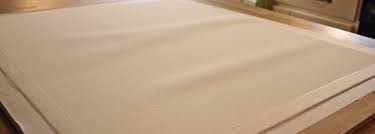

It goes wavy. I just went out to the shop to take a picture and the darned stuff is laying flat as a pancake. The dehumidifier has dropped the humidity down to 32% and all is well. I found a picture of something wavy online. It gets worse than this. Problem solved I guess.
I still don't get why the print media is immune to this. It would appear that the paper backing gets bigger from humidity and palstic laminate does not so something's gotta give and it goes wavy... but in all directions. I called it "buckled" for lack of a better name.

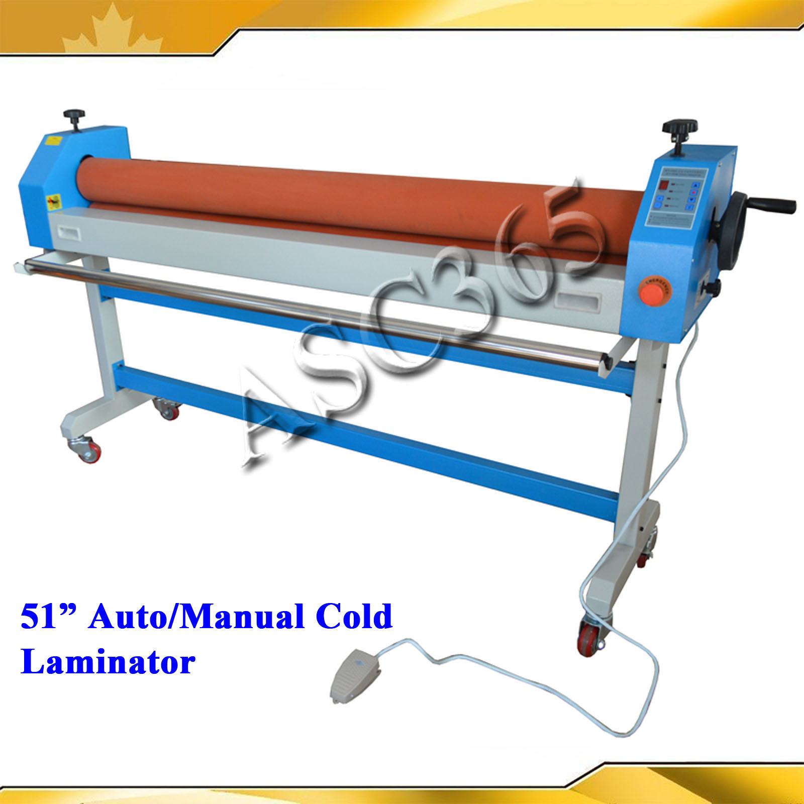

Chinese cold roll laminator. I cut a sheet of laminate the size of the graphic and then laminate the 2 using the power feed. I don't have anywhere to put the roll on the machine... or else I don't understand the procedure. I'll look for a picture of my machine.
GaSouthpaw
Profane and profane accessories.
I'm guessing it's the paper that's buckling. Maybe tack one end to a table nice and flat and hold taught.
Of course, running through the laminator is a different story. I always tried to get it nice and flat on my media, then making sure the feed roll was squared and the "nuts" that held the laminate tight to keep plenty of tension in it. That usually made things work fine even when there were questionable areas on the roll.
