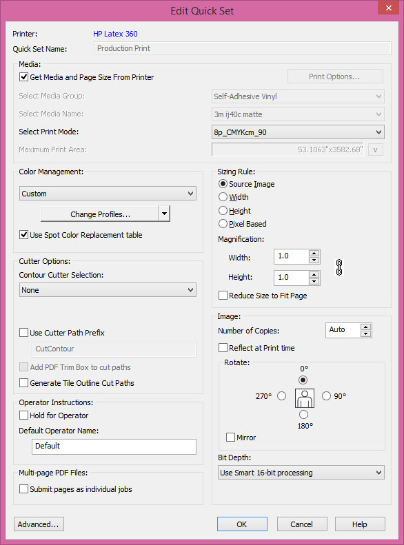

You can easily "Preserve Pure Hues" in the color management area of the quickset (use the help feature to guide you to the correct area of the software)
If you turn this on for yellow then a 100% yellow sent by the app in the file will remain 100% yellow in the print and not be converted by the profile.

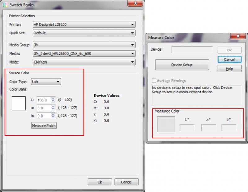

Is this something different than you're talking about? It's the ability to get LAB values from a spectrophotometer under the "Swatch" area.

The Onyx video a few posts backs very briefly mentions a button that will read in from a spectro and create swatches. It doesn't go into detail on the process but it looks like it will do what you need.

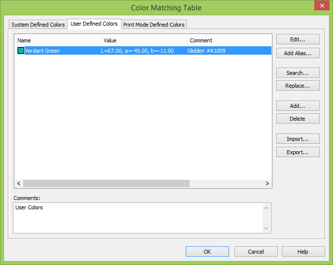

OK, here is how to capture LAB values from a physical specimen in Onyx:
1. In the main module of Onyx (RIP-Queue or Thrive) go to the Setup Menu at the top, > RIP Configuration > Color Matching Table. Note that there are two or three tabs (depending on your version of Onyx) System Defined Colors, and User Defined Colors. System defined colors are all of the myriad Pantone spot colors, as well as RAL colors. All of their LAB values are included in the database inside of Onyx.
The second tab is called User Defined Colors. This is where you go to create a new spot color.
Please see the attached screen captures for these two dialogs.

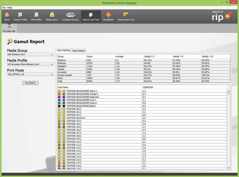

Also note that I have included a screen shot of a tool in the Media Manager module that shows a prediction of the ability to reproduce any color in either database (system or custom). Note that for the media that we have been referencing in this thread, Pantone 107 C and 108 C, the dE 2000 values are under 2, which represents a terrific round-trip match to the Pantone reference colors, for the specific media and print mode in question.

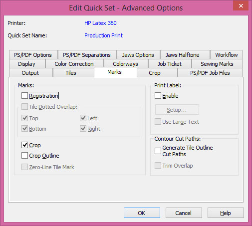

There is a lot of other basic RIP functions like grommet marks. frame marks etc. that I have yet to find. Maybe you can point that out as well.
Various types of trim, sewing marks and frame marks are available in Onyx, and are accessed through the QuickSet. Here are two screen shots of the basic QuickSet dialog and the Marks dialog that is accessed under the Advanced button in the lower-left corner.
Automatic insertion of grommet marks are available in the Onyx Smart Apps Illustrator plug-in, but are not in the RIP to my knowledge.

Various types of trim marks and frame marks are available in Onyx, and are accessed through the QuickSet. Here are two screen shots of the basic QuickSet dialog and the Marks dialog that is accessed under the Advanced button in the lower-left corner.
Things like grommet marks are available in the Onyx Smart Apps Illustrator plug-in, but are not in the RIP to my knowledge.
Are you serious? I should open my clients supplied PDF in Illustrator just to put trim and grommets marks and then re-save as a pdf. I don't need that kind of trouble. And, with so many other things going against it, this is the last straw for any Onyx consideration here.
