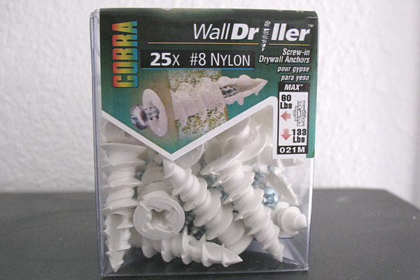

Billct2
For future reference, we used a similar technique, scews eyes with plain wood workers glue. But now we use screw in drywall anchors....
