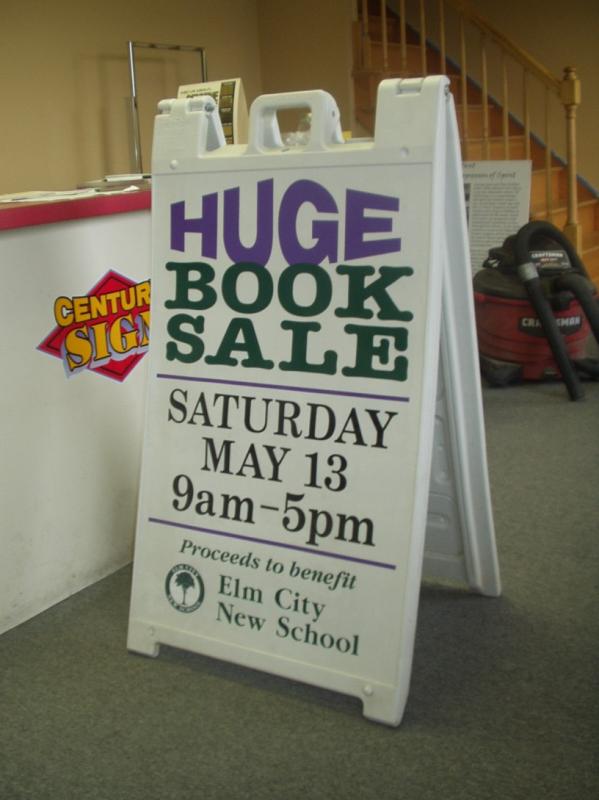

You can NOT use individual cut letters
Yes you can. Here's one we did which was used for years and we changed the dates each years. All cut vinyl.

You may get individual cut letters to stick right onto the polyethylene, but the manufacturer recommends against it.
