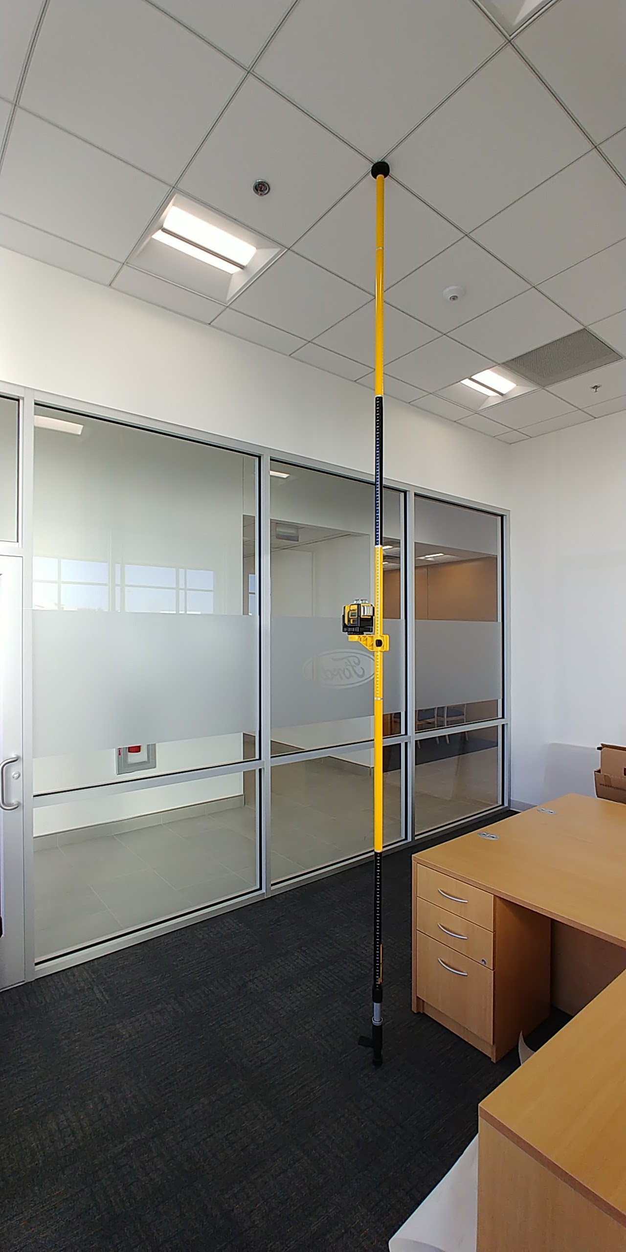

8510 installs very easily, especially wet. It's a thicker material so it's a little easier to handle. As mentioned, apply transfer tape over the cut logo portion, no need to mask the whole sheet (see photos). As soon as you have the whole piece applied, squeegee the logo portion pretty firmly to get as much application fluid out as you can. Then spray the transfer tape with your application fluid and rub it in with your hand. Let it soak while you trim the vinyl, get bubbles out, etc. Spray the transfer tape again, rub it in, start cleaning your tools/area up. Spray it again, rub it in, go to the restroom. Half kidding on the last part, but at that point you should be able to carefully remove the transfer tape from the logo. Peel the transfer tape back against itself, keeping it flat against the glass.
