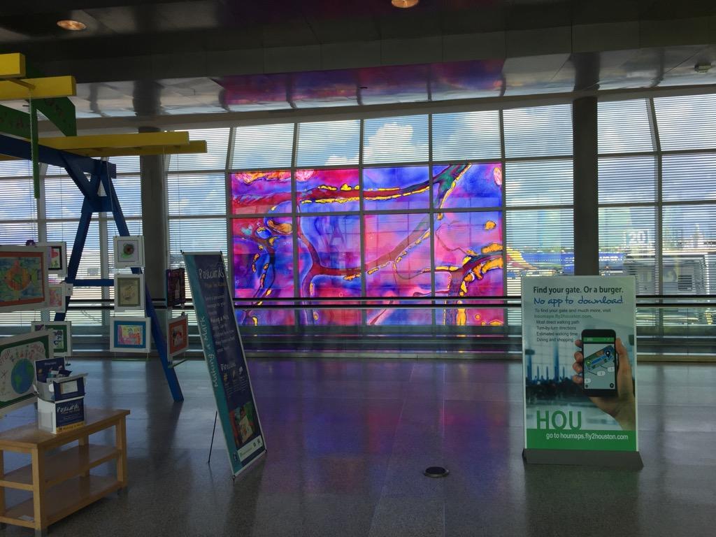

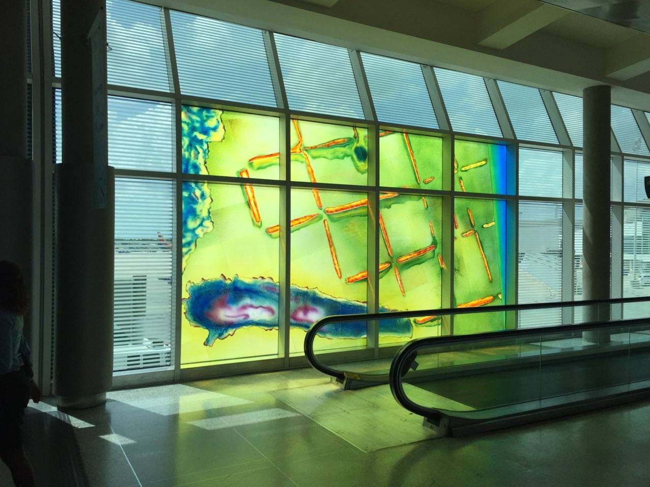

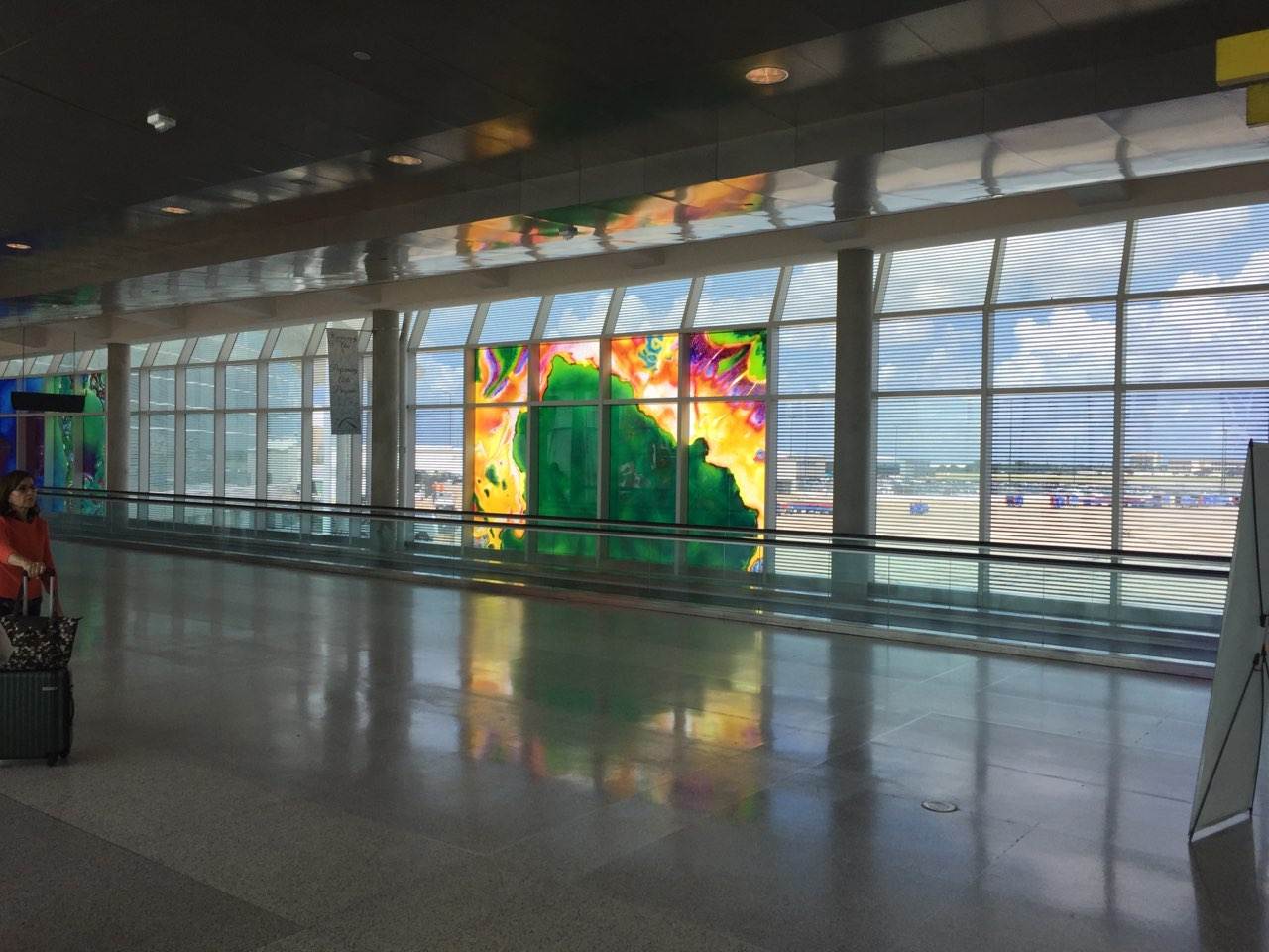

I have a client who wants something like this in their conference room. Can anyone direct me to the material that it is? Thanks.

Looks like printed frosted film, we usually add 30% saturation when running frosted on our Latex as the colours tend to look a bit washed out.
ikarasu
Looks more like 3M 8150 to me... Too transparent to be a frosted vinyl.

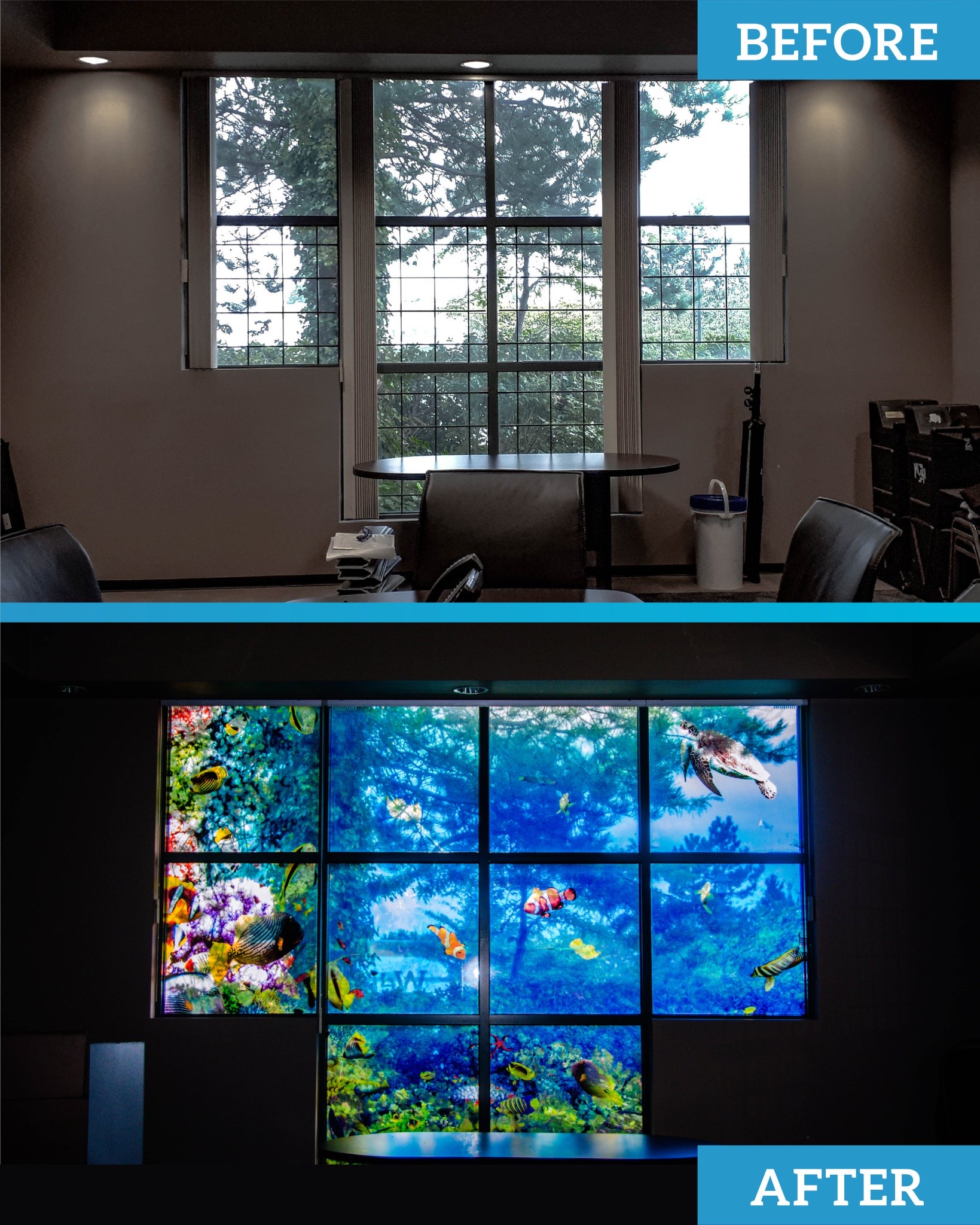

We do stuff like that all the time, works great but a bit pricey. Any optically clear vinyl should work.
Attaching one we did In our office. As mentioned... Use moreink. I believe we did 220% just because this side gets lots of sun and we wanted it to be bright and not washed out.

That looks awesome!

Agreed...no frosted. An optically clear vinyl is the most likely solution. General Formulations makes an awesome product...GF255...though shorter term specified and the price is a heck of a lot better than the 3m.
I think either will work, but the samples shown by the OP seem to be somewhat all opaque. You can't see the buildings outside her samples as you can see the trees through ikarasu's sample. Perhaps even a translucent might work.

That looks amazing! I did giggle a bit. It looks like the fish are swimming in the trees.

ikarasu
Haha..yes. It's not that bad in reality though. Our graphics artist Decided to shut all our lights off to give it a more glowing effect.
When it's daytime..and the lights are on in the board room it's not as see through. obviously it's still a bit see through, so if you have trees...you may not want fish :)

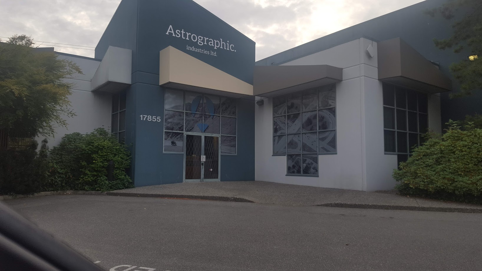

Attaching some frosted we've done. We do have some transparent we've done as well, once I find it I'll add it. You can totally see the difference between the 3. I still think your attached photos are printed on clear, its just theres not much in the BG in yours to see, and its darker colors. But I'd go with transparent, or clear... I like how bright the clear is, but to each their own!
[Edit] Just to add, the forsted was a greyish/brown print... All the colors / white in that photo are cut vinyl added to the front to give it a 3Dish type look.

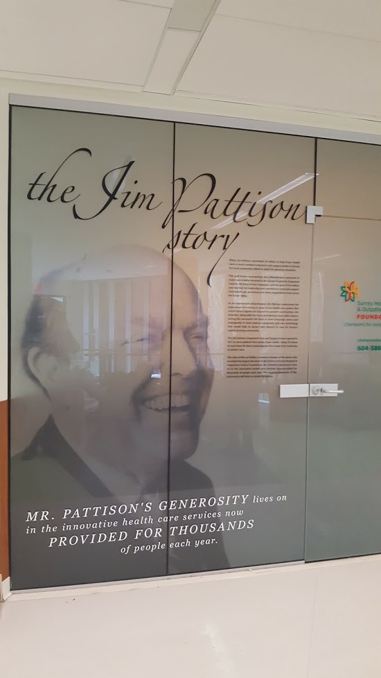

And the Translucent... taken on a crappy day.
Translucent is nice because the light shows through on the inside, but it's more opaque on the outside. I'm not too big of a fan of these graphics, Maybe because it's so grey and crappy looking I like the clear better... But I do think the clear is more shiny / vibrant.
Frosted is more of an interior/decorate look IMO. Great for show pieces/rooms, but I wouldn't use it on a huge window graphic.
The windows to the right are the ones we added the fish prints to... So the trees are directly infront. If it's in the distance, I dont think it'd be as noticeable.
