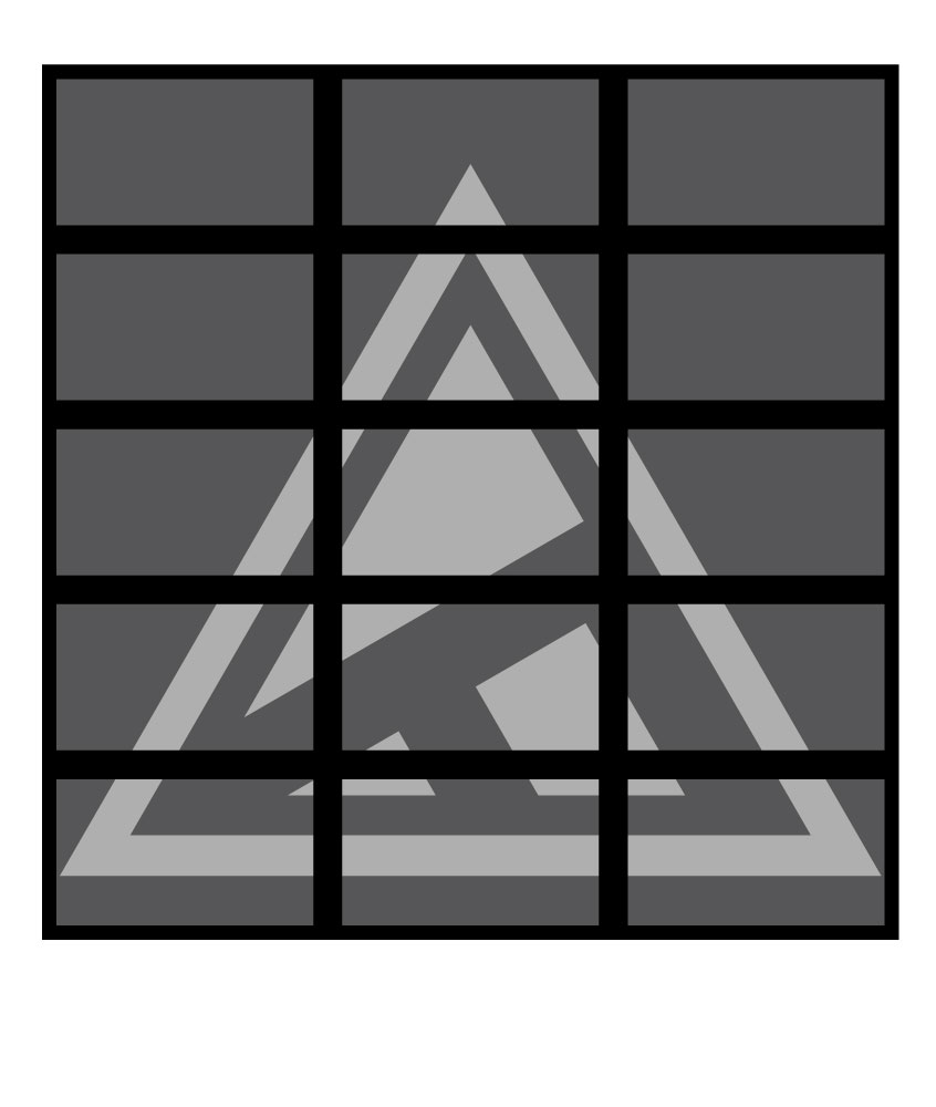

Hey! So... We have a client that is set upon the idea of covering his big roll up garage door windows with window tint BUT he would like his logo superimposed over the windows too. I have attached a quick mock up of the idea. He wants the entire thing to transmit light. I have been trying to steer him towards a printable etch but hes not sold quite yet. I don't have a ton of experience with tint other than I know it can be quite finnicky. Anybody with any experience for working with tint like this?

We've not done a lot of tint but this looks simple. Tint on inside and etchmark (or similar) on outside. Wouldn't be able to do the variable tints in photo 2 though.
It can be done, it's kind of a pain, though. You can do what Reveal1 said, but keep in mind that there are very few films that are designed to be installed on the outside of a window. The brand we use, Llumar, only has one single type if I remember correctly, and it has a much reduced lifespan compared to their other commercial/residential films.

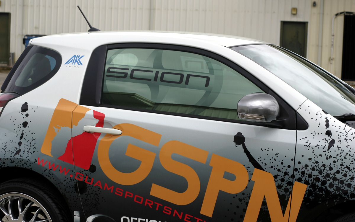

We reverse printed on clear - installed on the car windows (inside) then added a layer of medium (35% I think) neutral tint behind the prints.
Looked good and seemed to not bother the driver's view. Most likely not DOT Kosher, but we told them if it was an issue we'd remove and refund the cost. Might do what you need.

I would have done it the same way. Good thing you mentioned the DOT to them.
