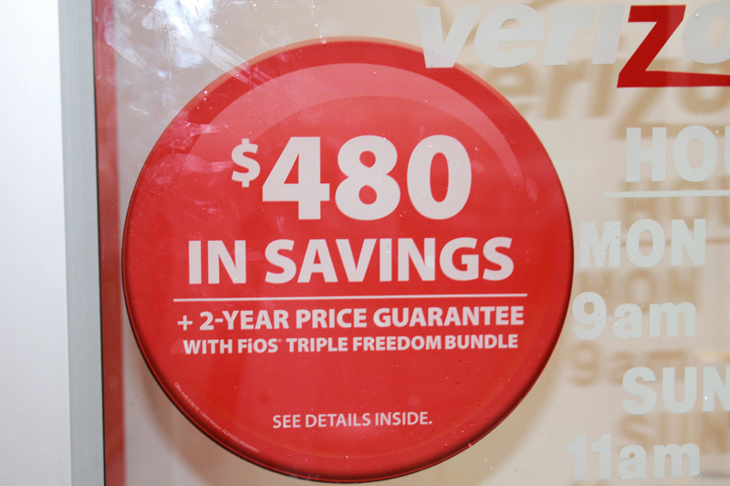

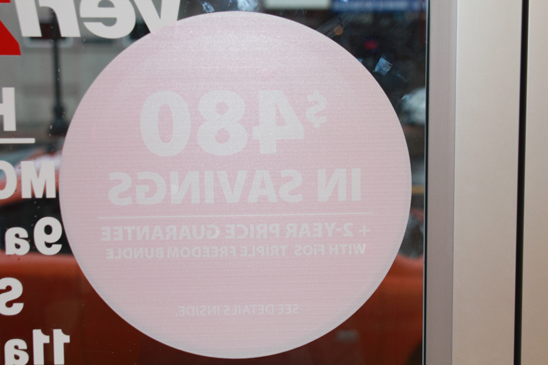

here are images of the decals i am talking about that i want to produce.
this is front and back sides on them on the inside of a glass door.
how is this made? translucent media with2 sided adhesive applied between front and window?

apex
anyone know or cant point me towards what kinda media that decal is

It looks like just normal 3 Mil calandered vinyl, the 3Mil vinyl will be a little translucent just like in the photo.
