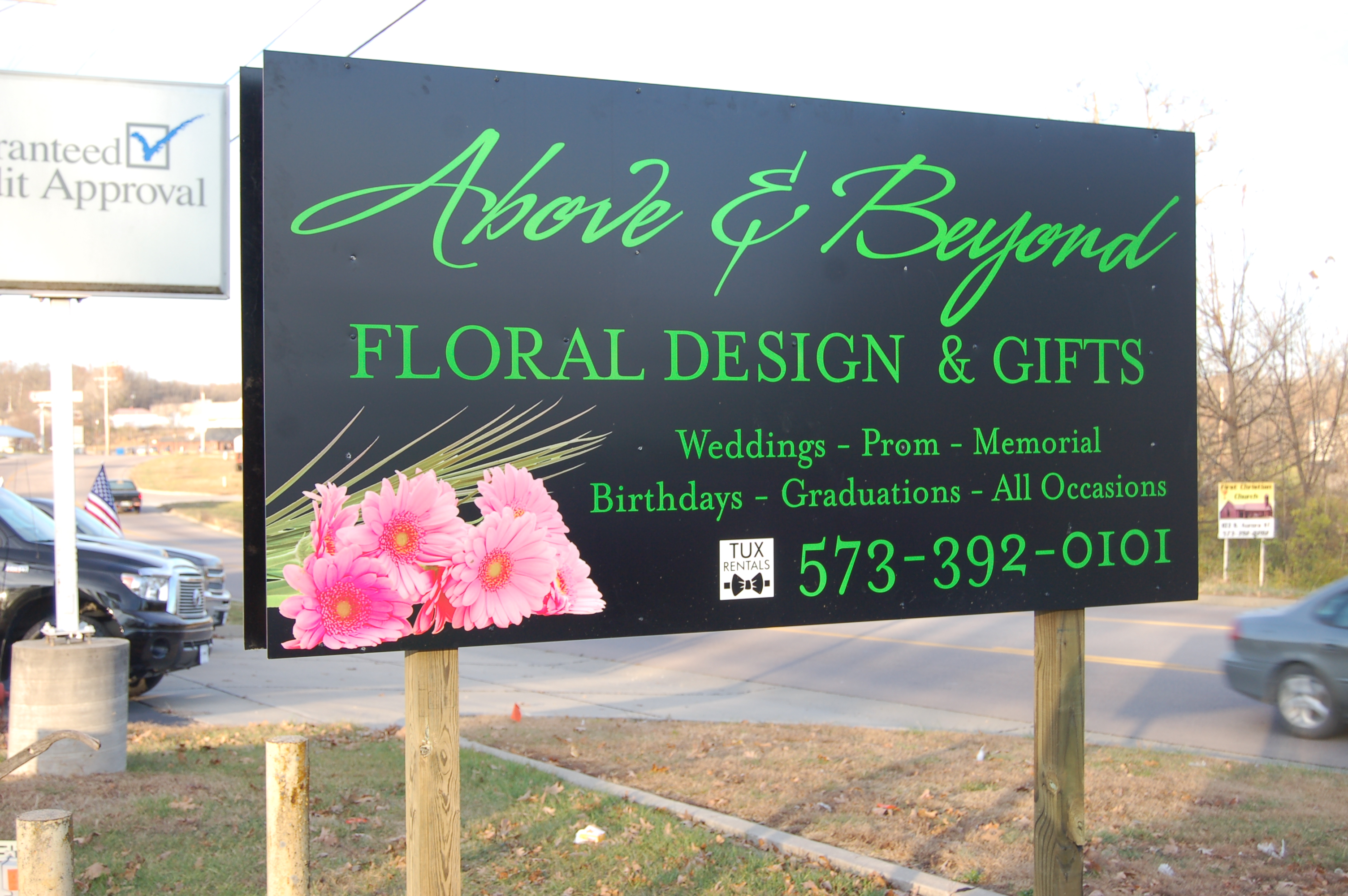

We use 3mm ACM for a lot of commercial signs. It just depends on how you install it. If you expect the sign to be structural, then you need 1/2" MDO. But we always expect the structure to stand without the face, and the face is just decoration attached to the structure so 3mm ACM is perfect for the face.
