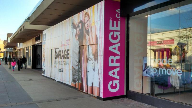

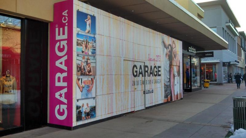

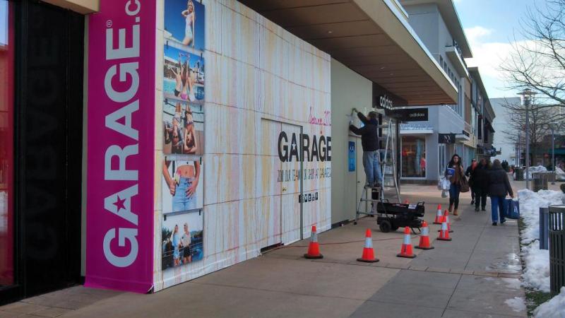

went well!! picked up a 175,000 btu torpedo heater. ran it facing the wall for 5 minutes where the next panel was going. warmed up the wall very well. killed the heater, hung the vinyl panel, then kicked the heater back on while squeegeing it. leaving the heater on while removing the backing and hanging the vinyl left for mushy vinyl so we had to turn it off during that. not a bad day for a high of 35!
