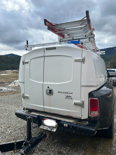

Got a request to wrap this truck box - both sides, front, back. Not the top. Customer wants it charcoal gray to match the truck, logo/text on sides and rear. Has anyone wrapped a box like this? The rear doors look tricky having to deal with the indentations and hardware. Any other challenges I might encounter? I don't have much experience doing wraps and don't want to bid on something above my skill set.
signheremd
The back doesn't look bad at all - assuming you use wrap vinyl to change the color. But remember, you will need to clean this really well to have good results - about half the time you have it - I would windex it first then hit with alcohol or Rapid Prep twice. I think you can do this in 2 days (1 of them just for cleaning), and should keep it one more to make sure nothing needs to be re-squegeed. I would trim around the hinges as seams pull apart. I would also expect to have a seam where sides/roof meet back. If he can remove the ladder racks, or you can, it will be much easier to lay the roof. If he wants the sides inside the bed done, the whole thing will need to be removed from the truck bed.

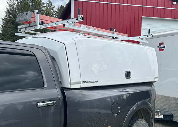

Customer wants the "front" wrapped also, meaning the side that faces the rear window of the truck. So the whole thing would have to come off and be left in my shop for a couple days. Here's another angle:
