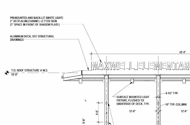

We are bidding a large job for a military base. Nothing new, done it before, going thru the plans and then I come across some terminology I have never seen. Am I missing something here? what is a dam shadow plate! I swear architects smoke a bowl when they start designing stuff and referring to sign terms
these are lighted letters bottom mounted to a canopy

Dunno what confuses you. Pretty regular stuff, i do understand it all personally. Did sort of same project for Burger King

And yes, shadow plate means halo lit

Look Im not gonna start a whole new fussin post BUT in my original post I did ask what a shadow plate was they were referring to. IMO they dont even need to light these letters up on the canopy, waste of money. just put some dam brsuhed aluminum up there
and be done with it lol

We go thru same BS from time to time, they send you drawings, requiring specific stuff, then you realize that its stupid & trying to explain that there is better way... 9/10 will refuse anything else. So if i would be you, i would just price out whatever they want & maybe do a another quote for what you think would work better

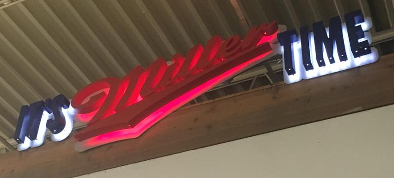

i know what it is...
:toasting:
(aluninum faces, 1" welded aluminum returns, backed with clear lexan & filled with white led's, 1" standoffs mounted to aluminum backplate)

Wait...Maxwell Air Force Base Elementary School....which is only open during daylight hours and locked down like a nuclear weapons facility when it's dark needs halo lit channel letters?! Why? So the birds can see where to build nests at night?

pat that was exactly my thoughts. maybe its for those dreary winter months. if you think thats bad you should see the plans for the new school at montgomery mall pay. That damn sign package was $90k. and $60k of that was over the top BS that has no need. those hoodrats will tear that stuff up in one school year
