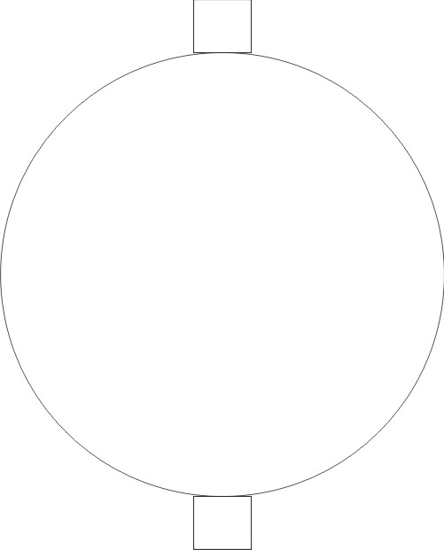

Shovelhead
Pretend the squares are hearts......
copy and paste top and bottom hearts...
click the pasted hearts twice to expose the skew and rotate tools....
while pressing "Ctrl" grab the rotate arrow and rotate.........
they will constrain to 30 degrees.........
copy and paste the 30 degrees hearts and repeat steps until circle is complete

niksagkram
The "duplicate" command (ctrl+d) works well for this too.
Make your top and bottom hearts, duplicate (ctrl+d) rotate 30 degrees,and now, while this duplicate is still selected, duplicate again. Corel will repeat the 30 degree command each time you duplicate your selected hearts. (ctrl+d, ctrl+d, ctrl+d, ctrl+d, etc..)
One thing though, make sure your duplicate distance is set to zero for both x & y axis, as in attached image.

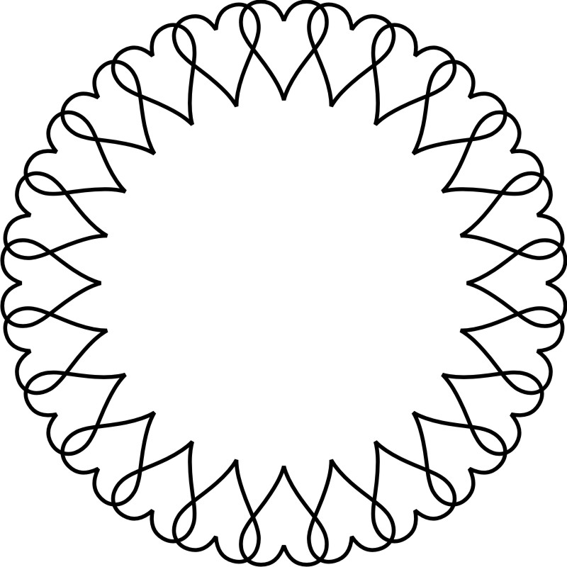

bob
You guys work too hard...
Just set up a pair of opposing hearts as Shovelhead did and combine them into a single object.
Then do Arrange->Transformation->Rotate. Select the degrees to rotate, any number thats a factor of 180 will work, the smaller the more overlap. Make sure that the Relative Center is unchecked and the center of the 3x3 grid is selected. Now just press Apply to Duplicate as many times as is necessary to fill in the circle.
The whole process should take less than 30 seconds.

niksagkram
Bob... thats basically what I said, except I used the short cut keys. And you are right, it takes less than 30 seconds.
