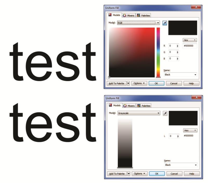

So, I've opened the file at home in CorelDraw X5 and here's what I get when opening the Uniform colour diaglog box for the top and bottom words.
I take it you're getting some other colour when you do this?

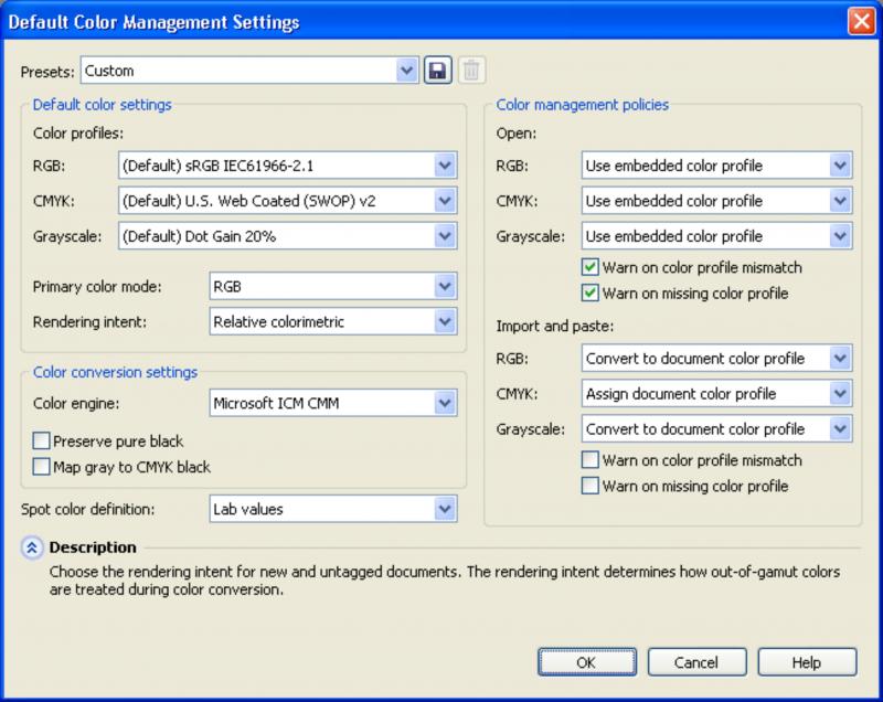

Have a look at your Colour management policies - See attached.
Roto
  • Colour management.pdf
No, that's what mine looks like, but where you're says "Hex", mine says "RGB" and it shows the values as 0,0,0 for that. But the text all says the same as yours, and the L=0.

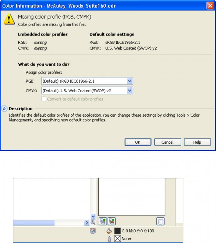

I turned on the warning messages and this is what I got. I think our equipment people have always told us in the past that we should turn this off, so that's why it has no profile.
Any ideas how to fix this?
You can see the bottom image is an old file that was solid black. It's brought in as CMYK.

So, if I'm understanding this correctly, you've created thousands of CDR files using X3, and did not save any of them with a colour profile embedded?
If that's the case, then it looks like X5 has taken note of that when you open one of these files, and is offering to assign the default profiles. Doesn't sound like this is much of a problem -- unless I'm missing something, here...

I have the settings set the same way listed by Roto, but it doesn't change anything. I guess what I'd like to do is to turn off the profiles so it doesn't change anything when I open a file, I think.

Can you take a screenshot of the same dialog box that Roto put up to show us what your current settings are?
CES020
Sure thing, here you go. I spent the last 1/2 hour trying to find out how to turn color profiles off, but I haven't found it yet.

Right off the bat, I would try setting "Preserve pure black" to on...

Have you tried setting the Colour Engine to "None" under the Colour Conversion Settings?
And maybe also set your Primary Colour Mode to RGB...
