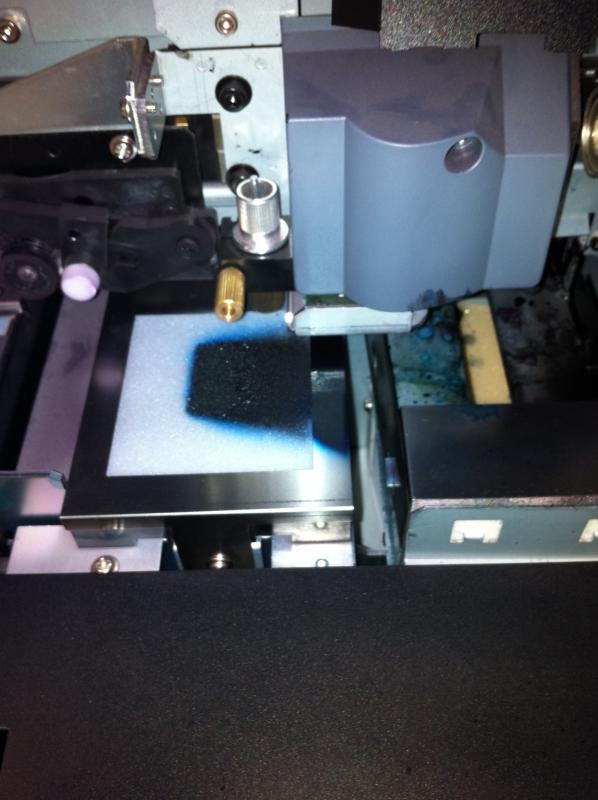

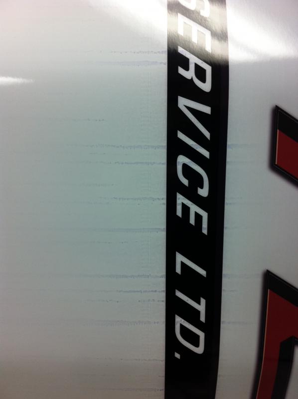

Hey all, we have had our XC-540 for just shy of 2 years and it has been an incredible machine! It works almost non-stop and it has never given us a second of grief until the last month or so. I am now getting overspray all the time. I have done multiple medium head cleans, manually soaked the heads with a swab and cleaning solution, pinched the cap drain lines after filling them with cleaning solution and left it for an hour and nothing has helped. It is not a static issue as it is in it's own room with no carpet and a humidifier running 24/7.
There is no dropout on any of the heads with a test print either, no visible marks on the heads at all and it is extremely clean. I will include 2 pictures, one of the overspray/streaking and one of the sponge where you can see that there is too much ink coming out by the looks of it. It seems to be most prominent on blue prints. I have an order for 1500 small stickers that I can't print because they are 90% blue and I need to figure this out first. If it is a head gone bad than so be it but how does a person even go about figuring out which one? Thanks for any help you guys can offer. I have read through some other posts but as I said aside from the overspray there are no other issues I can see too cause it.

Different media makes no difference. The only reason I say static is not the issue is because of the massive overspray on the sponge area. Neither of our 300v's did that. Also aside from the humidifier I also have anti-static electronics spray that I use regularly and the problem also just appeared one day. It didn't really start and get gradually worse. And as I said it is much worse on prints using mainly cyan. Static, I would think, would cause similar issues on all colors?

More than likely it sounds like a head going bad. If you have been running the printer non stop for 2 years you may have a bad head. Even a bad head will have a good test print. Your Roland tech can run sample prints which can tell.
We have had our printer for 4 years and run it every day and had to start replacing heads at 2-3 years. Best printer I've ever owned hands down.

How did ink get on the bottom of the cut head cover? Have you ever had any heads replaced? Could be open head... Head strike lately?

I believe that was just an accidental swipe from a swab during a cleaning. All original heads and no head strikes for well over a year. I believe only once before.

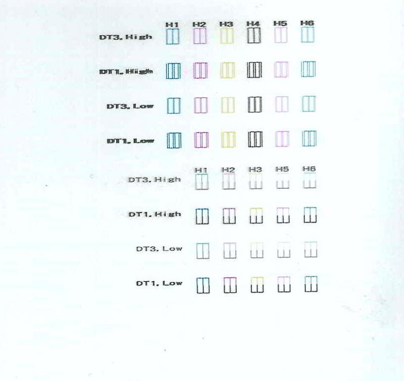

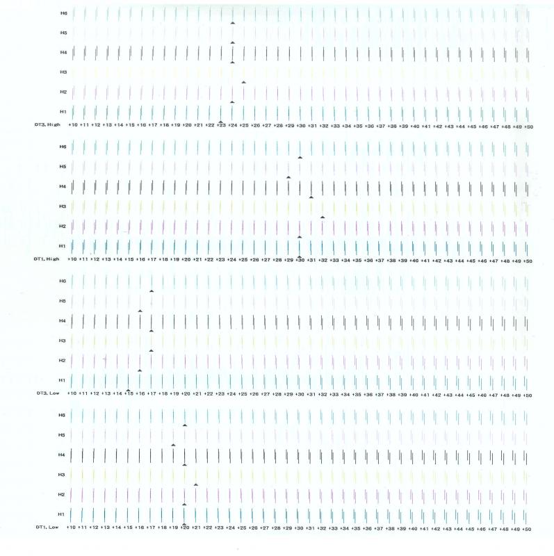

While in Service Mode, Print your Bias, Vertical, Horizontal and Bi-Di patterns...
Another thing you might try is to swap the ribbon cables on the Cyan head with the next head over... (power off and unplug printer first).
This might tell you if it is the head or something else electrical in the system.

This is a bad head. As for which one, I am guessing the cyan head, but getting into service mode and doing the vertical, horizontal, and bi directional adjustments will tell you. If these colors aren't printing right in these tests, it will help you narrow down which head is going bad.
The head has worn out and doesn't know where to spray. Our xc-540 did the same thing and the only thing that stopped it was changing the head.
It looks like when we replaced ours, ours was the Black head. I don't remember why I came to this conclusion, but it fixed it.

Ok, here are a few scans from the tests. If anyone needs to see something else please just let me know! On a side note do most of you have your head height set high or low on the XC's for vinyl?

I don't see anything wrong with the test prints, but the resolution isn't very high on the scan, so I can't see them as nice as I would like to.
