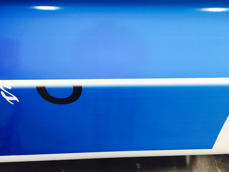

Friday update: Printer is STILL not usable. The tech was very knowledgable and pointed out multiple problems with printer which he replaced including a wrongly set up takeup bar (which was setup by Roland themselves), wrongly installed (and broken) pinch rollers and some other things. Cables/heads/dampers more and more.
Tech yesterday got it running (by running I mean spitting ink) but I'm still seeing ink dropout. Tech mentioned that it could be our profiling and I said no way. I've printed hundreds of wraps on our profiles with zero issues. In fact the test wrap we we're running was printed right before the printer went down with the exact profile.
Printer is getting erratic ink dropout at 720 and 1440. No word from Roland yet. I feel like maybe the encoder strip is bad but I'm not the tech. Still not production acceptable. Between multiple techs and servicing they've burned through an entire set of ink and 2 metallic carts. Guess who paid for that? Not them....
Roland.. Roland...
Oh. And thank everyone for the multiple emails and private messages containing their issues as well. Roland makes it seem as if I'm the only one and I KNOW that's not the case.

Tech that came out tested a file of ours on our printer in a generic Roland profile with banding and dropout on Thursday.
Tech printed exact same file on their demo XR640 printer with the same generic profile and it printed perfectly clear which he suggests there is still something wrong with my printer.
Tech is relaying info to Roland.

Hi there, We have the exact same banding / "striation" issue and eventually found out it was caused by media slippage under the outside pinchrollers (these are angled pinch rollers unlike all center pinchrollers).
Basically the firing path of the droplet is microscopically moved as the media is held back or slips forward causing both vertical and predominantly horizontal striations in the print which look like starvation but arent.
Ideally with the XR you must use as many if not all pinchrollers if they do not cause marks - if they do and you only run the outside ones make sure to not use the take up system and pre-feed quite a portion of media so the drag remains equal throughout the print. We have found this to be the only work-arround for now and have a pending query with Roland Japan on either a change over to softer pinch rollers or a way to increase the tension on the media. Also ensure the physical alignment and electronic alignment is perfect using PET film and loupe prior to the above. Also (I didnt read the whole thread - so sorry if this has been mentioned) there is a recall on the dampers (not related to your issue) whereby these are replaced by new ones which do not swell and cause the heads to overpressurize (when they touch eachother in swollen state) and leak.
The XR is indeed a disappointing machine...
