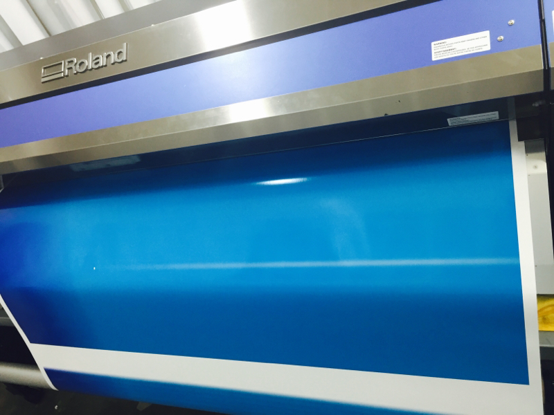

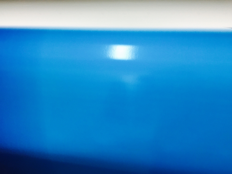

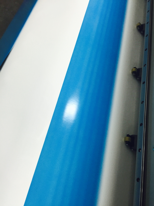

I don't even want to get into the mess I've encountered with the xR640 over the years but I need some input. Hoping someone has seen this because I need this printer operational asap and my tech is having no luck. I'm on my 2nd or maybe 3rd replacement printer. I can't even remember anymore.. I believe the 4th or 5th set of heads, countless cap tops and dampers. All under warranty and now extended warranty. I'm getting ink dropout which is causing crazy "banding" like the attached images. Tech just replaced both cap tops and dampers today. Any ideas on what this could be?

tried different profiles? even the wrong ones, like a default Roland profile? I can't imagine any other issue that would span across multiple machines. Media, power source, ground, RIP, RIP PC, network? I haven't seen a print problem that wasn't fixed by replacing the printer.

Same machine unfortunately. Mostly problems with the XR640. My other Roland's run fine. Custom profile that's printed 10+ of this same exact wrap file within a month of this issue. Power source and network all good. I can take the same material and move it over 10' to another printer on the same rip and it prints great.

Middle pic looks like starvation. Might be some junk floating around in one or more of the lines. I'd start with a full flush while watching the lines to see what comes out. Make sure the ink train is fully functional and work forward from there.
Hmm...have the ribbon cables been replaced yet? So much mucking about in there could have done something.

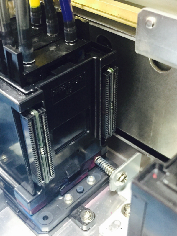

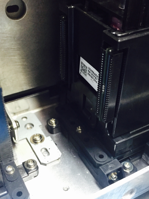

Looks like my tech figured it out. One of the plastic holders is missing the tab that holds the dampers in place. This could cause air intake. Now that I'm aware of this, it makes me think of the countless panels I've reprinted over the last years that had random white lines through a middle of a print. Well, now I know why I always have to reprint and pay out the *** for extra material.
