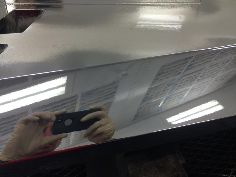

PainterDave
here are a few samples I do with HDU.
I put every finish you could think of on this stuff.

PainterDave
blow sigh off well
prime 3 coats of automotive polyester primer with a 2.0 tip on gun
let dry for 20hours sand with 150 grit
use sikkens kombie putty to fill any big pin holes still showing
and reprime using polyester primer let dry sand 320 and paint it with whatever you want.
shouldnt have any imperfections at this point if thats what youre looking for

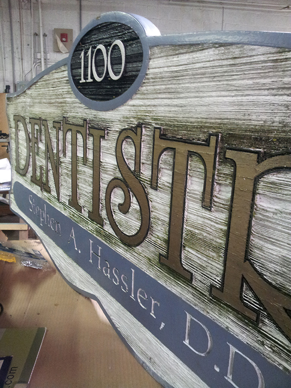

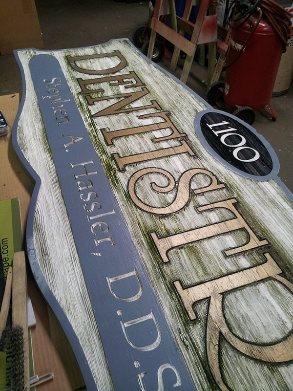

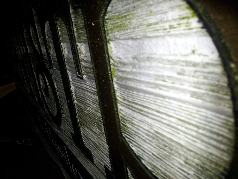

Not to bust anyone's chops, but a customer just brought back a sign we did back in 1991. 25 years ago. It's a redwood sandblasted sign. There is no peeling, no blistering, no nothing. There is mildew on it, but it fell over yesterday he said from the high winds. He then told me he was doing work and pushed \hard on the sign and loosened it. The next day it fell over. So, he wants me to refurbish it. I'll get a picture of it and show you what paint looks like 25 years later.
Baz
Don't skimp on the primer! Top coat use whatever you know and trust (for outdoors of course).
Spray finish is always nicer. Two coats of primer ... 2-3 coats of color.
This sign was made in 1991 on clear heart vertical grain redwood. Even the back still looks fine.
That was all latex primer with 4 or 5 coats of 1-Shot depending on which color we're discussing. It was not sprayed. Roller and pig brush, with hand laid 23.5kt gold leaf. We will be sanding down to the bare wood and scraping out the best we can in the fins and top coating it back utilizing basically all the same colors.
Other than mildew, no paint has even started to peel or blister. When prepped correctly, the oil base paints will last a long time. I've been using them for almost 45 years. Latex, I don't know about, but they don't seem to have the history oil based paints do. I used latex back in the 70's, 80's and 90's, and none of it lasted more than about 5 to 8 years.
So again, just calling out a procedure because you don't know how or don't care to investigate, is just plain dumb. Once ya have years behind ya, then you can speak up. :thankyou:
