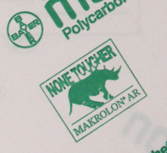

I think the polycarbonite with the Rino on the cover seems to hold up the best from yellowing.
Johnny Best
Makroln has the Rino Sheffield Plastics by Bayer
That's an old sheet. They changed name in 2015.
Btw there are two types of polycarbonate : UV protected and standard.
UV protected can be coated but best is coextruded.
UV protected means there is a thin layer absorbing UV radiation so the rest does not yellow (so much), which is backed with a 10 or 15 year warranty.
If you manage to get the yellow off a yellowed PC sheet, then it means it was not UV protected, and you wash off dirt, and with more aggressive solvents you take off the top layer (20 micron typically).
When you do this with UV protected PC, it was an older sheet, or it was exposed to chemicals before, and will end up like a non-UV protected sheet
