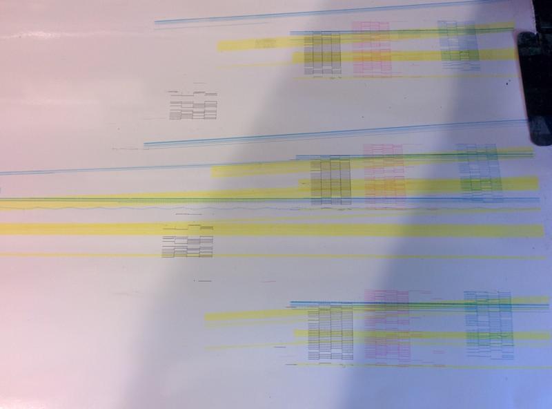

BUT......yellow and cyan seem to be printing alllllll the time. Check out the image.
They both a spitting out ink as it leaves the home position....and all the way back.
UPDATE: Re-seated the head ribbons. Now the yellow streak is gone! But still got one line of cyan. Also lots of missing on the test print, but one problem at a time LOL!!!

constant printing can be a cable issue but it can also be a blown head (possibly channel on the slider board). you are a bit green with the printer tech stuff to be doing a data swap. but, if it were my printer, that's what i'd be doing. you can search the site for "data swap" to see many discussions about how this can isolate if a channel or head is blown. also just trading cables from one head to a different head can point out if a cable itself is bad. if the ends are frayed, you can carefully trim them with some nice sharp scissors to clean up the ends.

Turns out one pin in the data cable had bent back over itself. Took a exacto knife and straightened it out. Working now. But I will save some future pain, and get all new cables. Still need to flush the rest of the heads.
