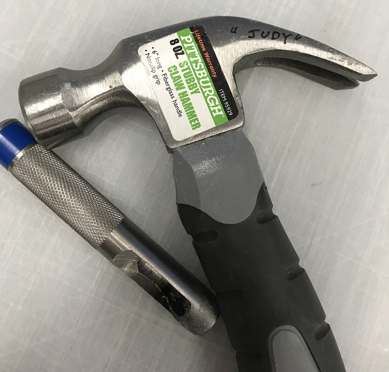

Hey folks. I need to get a small table top hole punch that can punch a single 3/8" hole through 10mm coroplast. I have tried drilling the holes and using a punch tool w/hammer, but neither option gives me a clean cut. I don't have a CNC, so that's why I'm looking for some sort of small tabletop punch recommendations. Thanks :)

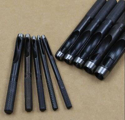

Have you tried a Bore Punch?

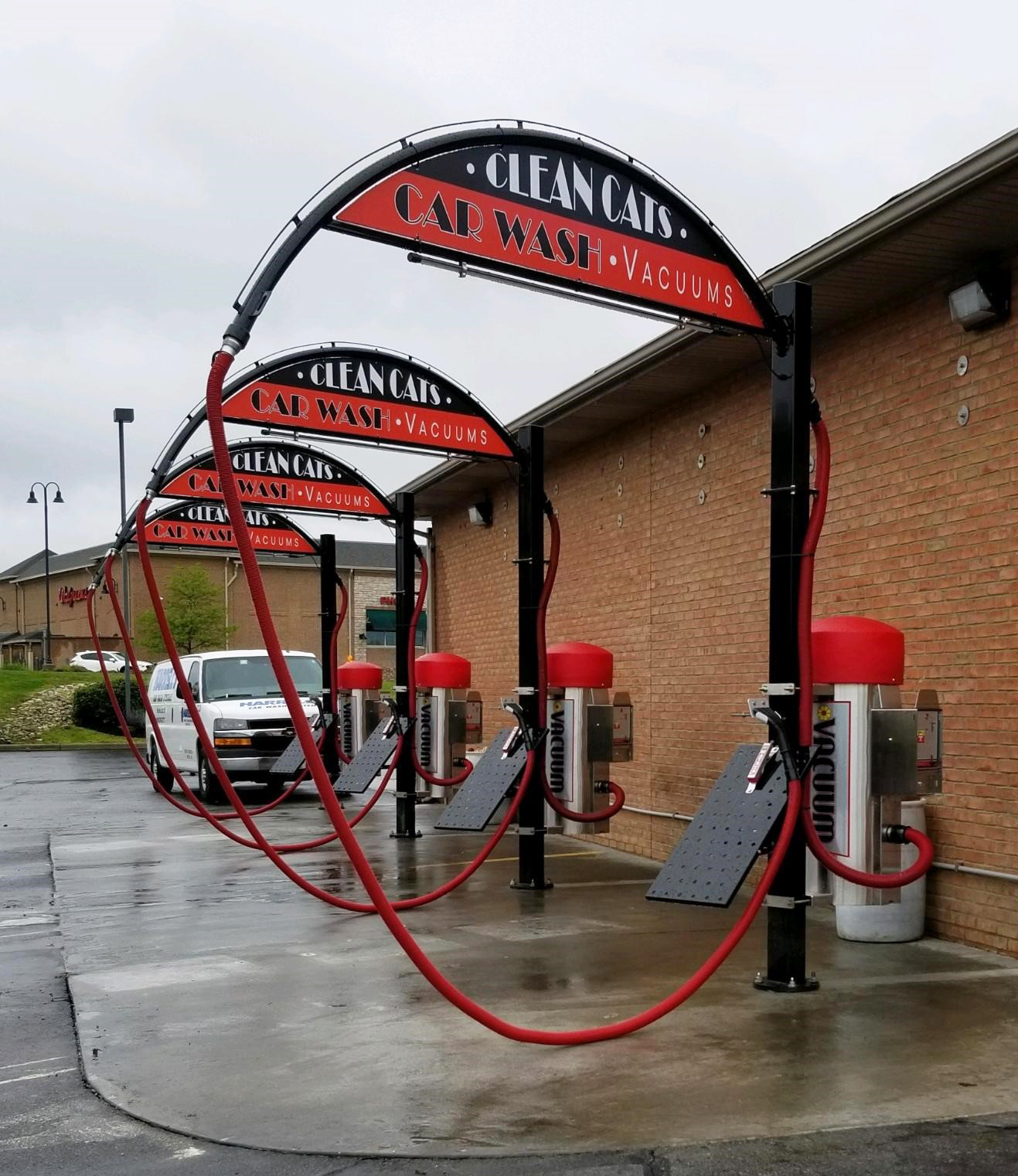

I know, I know....I'm just a perfectionist when it comes to clean holes though. Especially when the coro is so high off the ground, no one will see it anyways (see pic). I'll just continue with my hand punch and Judy, but 80 holes will take a long time, just trying to find a more effective and less time consuming way to do it.

First, I hope that picture is not your design. That's Horrible with a capital H.
Next, I can't believe you're only using Cor-X in something like that. You do realize Cor-X is a temporary exterior product... even at 10mm.
Last, they make long-neck grommets and it fits 10mm.
MHester
Last, they make a long-neck grommets and it fits 10mm.
Hehe. First, nope not my design. Second, yes, it's supposed to last only a year, its a temp. And Last, I 'll look into the long neck grommets, thanks for the tip. P.S. Thanks for the laugh :)
