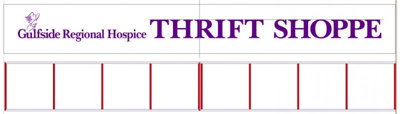

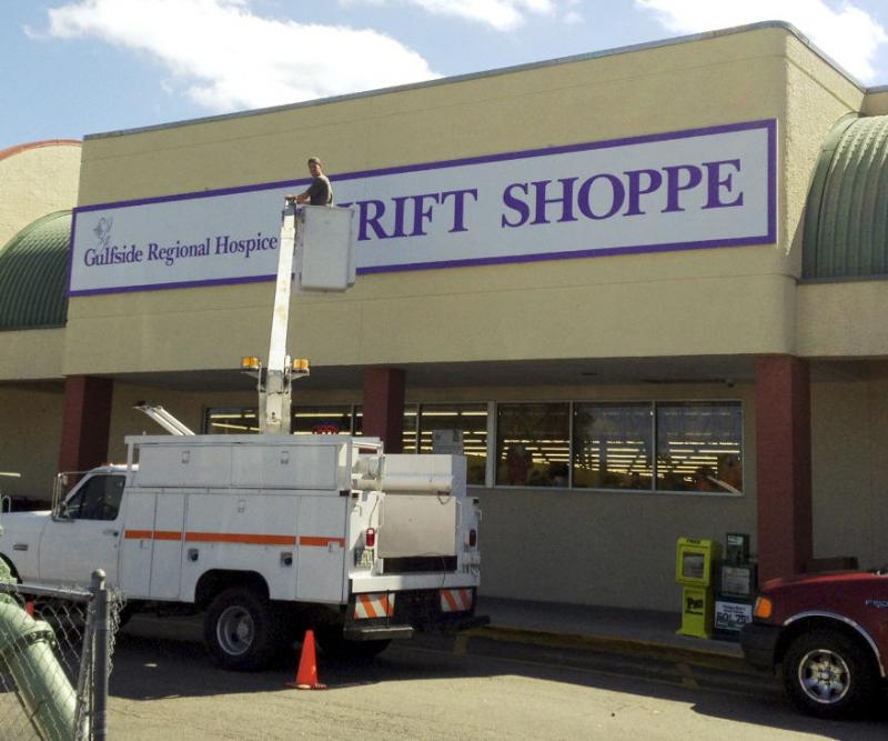

I recently made a 5'x40' sign using four 5'x10' sheets of polymetal. I built my frame from 2"x2" square aluminum tubing with vertical spars on all the seams. Attached the faces with VHB and also sheet metal screws. I built mine in two sections, 5'x20' but you can build your in one piece so long as you don't have any problems transporting it.
