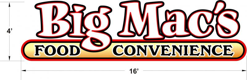

Hi and Happy New Year. I am doing a 4x16 ft sign on vinyl coated .081 aluminum that I would like to use both printed graphics and cut vinyl on. I also want to hand letter some portions of the design with 1shot enamel. Does anyone know if I need to prime the vinyl for the 1shot first, or can I just clean it with wax and grease remover then apply the paint? I don't need all the 1shot haters to tell me to use something else. I'm not worried about fading, i just want it to stick.

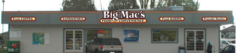

Thanks for the fast replies folks. We get the aluminum from Sherine Industries in Vancouver, and it comes with a white vinyl laminated to it. I'm cutting it to follow the contours of the lettering and graphic components and I want to hand paint a 2" border and an outline around it. Both my plotters and my printer only do 30" so I can piece together the outlines if I have to, but I can handletter it so much faster. I originally wanted to paint the whole sign on MDO but they wanted aluminum.

I've used krylon in the past many times, but in this case I'm not spraying anything. I have aluminum that came pre-vinyled. It's now cut to shape. I'm using a combination of printed graphics and cut vinyl and I just want to outline the larger letters with red and black like in the design I posted. I'm going to scuff it and use the 1shot. It faces north and gets no sun. Thanks everyone for the replies. Y'all have a great new year.
