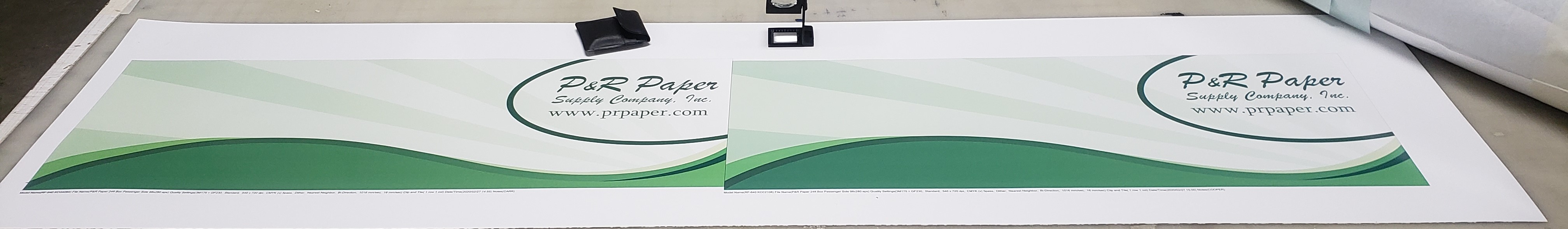

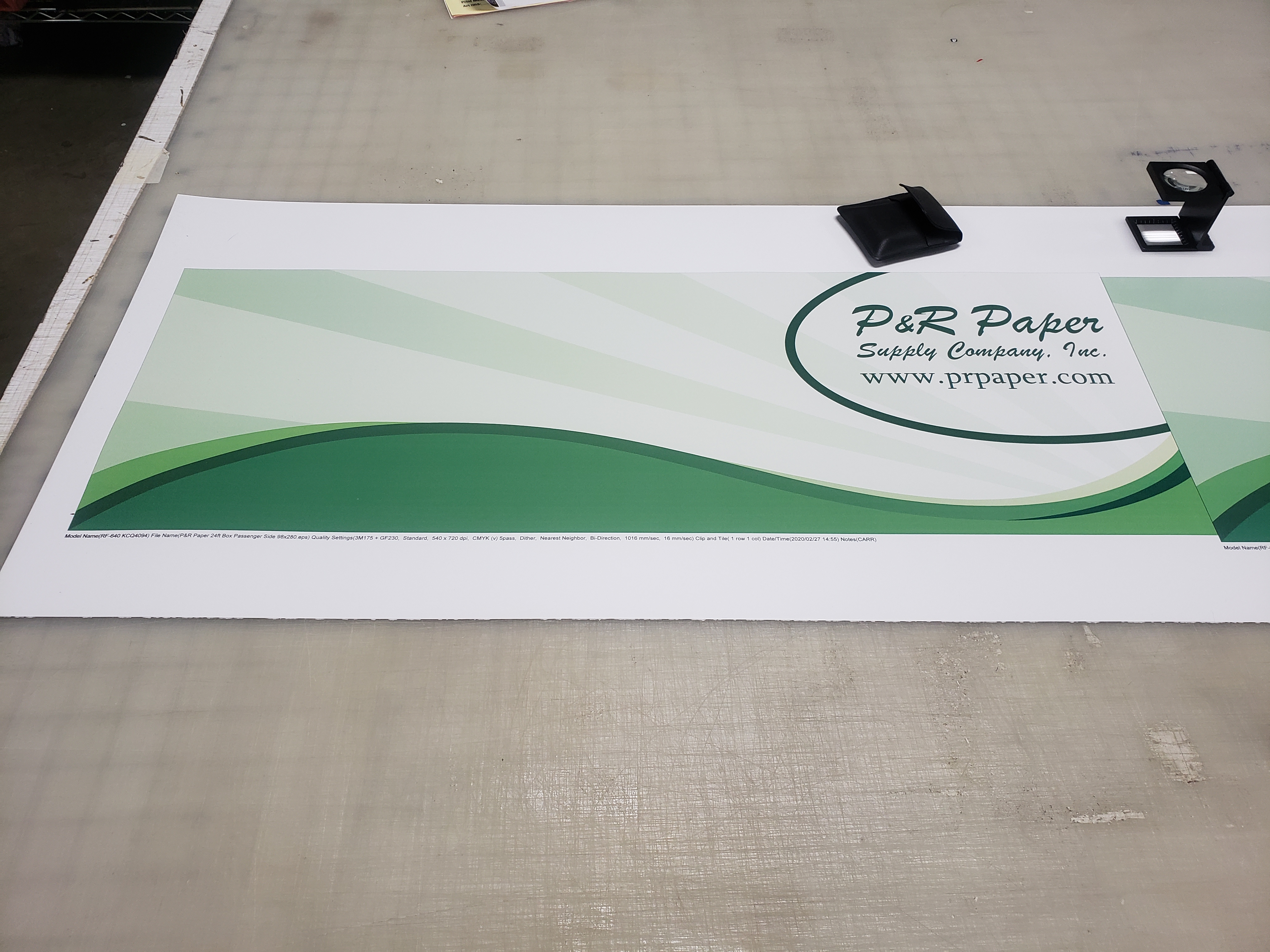

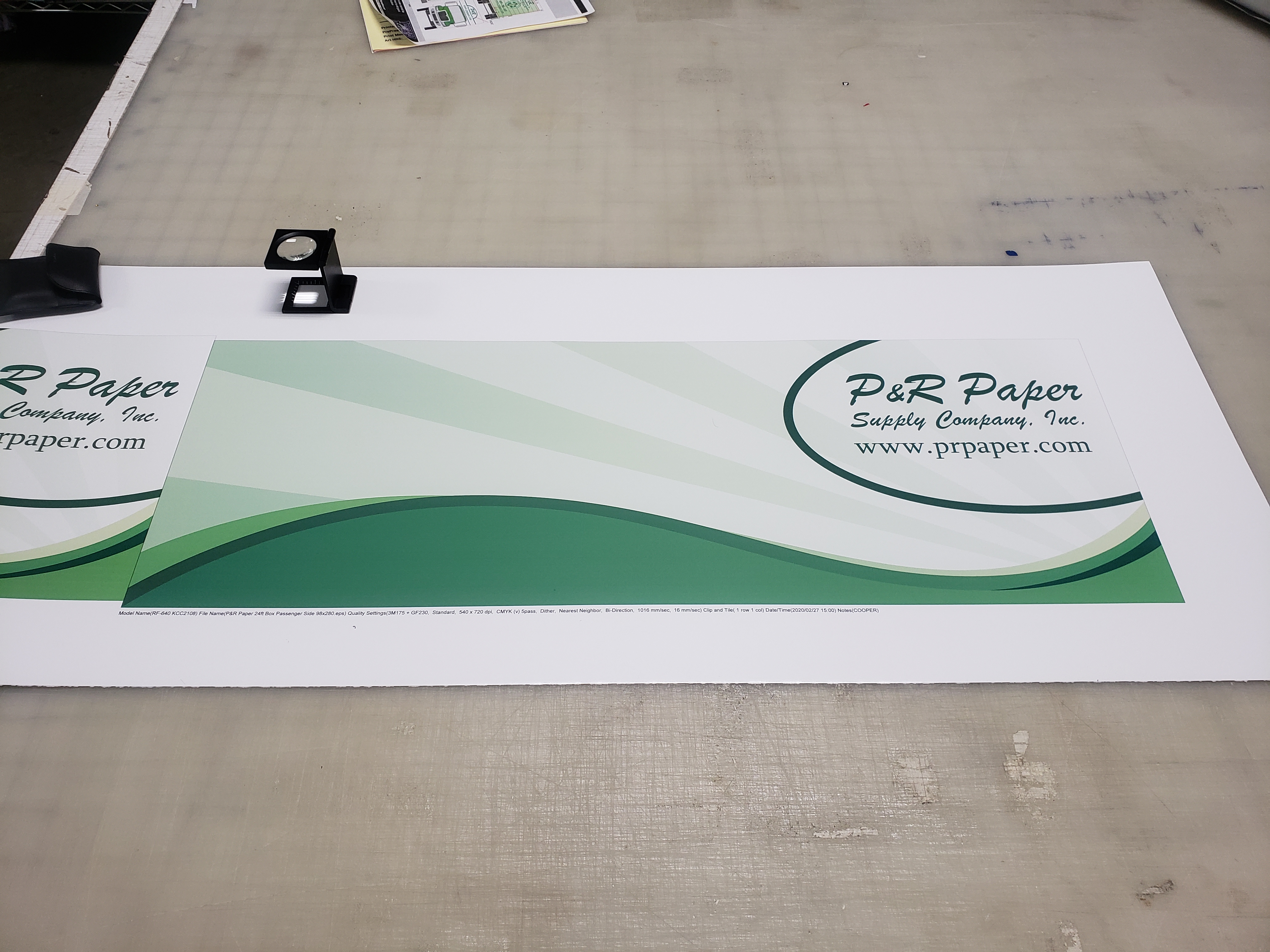

We have 2 Roland RF-640's, Everything/setting are the same. Same Print Profiles, Same File (eps), same machine settings. (same everything) Yet we are getting 2 different color prints. We used to get the same color prints before about 3 weeks ago. Nothing has changed.
One printer (CARR) is printing perfectly. The other (COOPER) is printing with a little more cyan, also it looks a little dull. It might be hard to see in the pictures attached. But it is clear to everyone here there is definitely a deference in color.

Don't rule this out just because you haven't had problems in the past. It appears from the pics you posted that yellow isn't firing as it should on the print on the right.
You didn't post a print of the nozzle test - that's always where I start.
