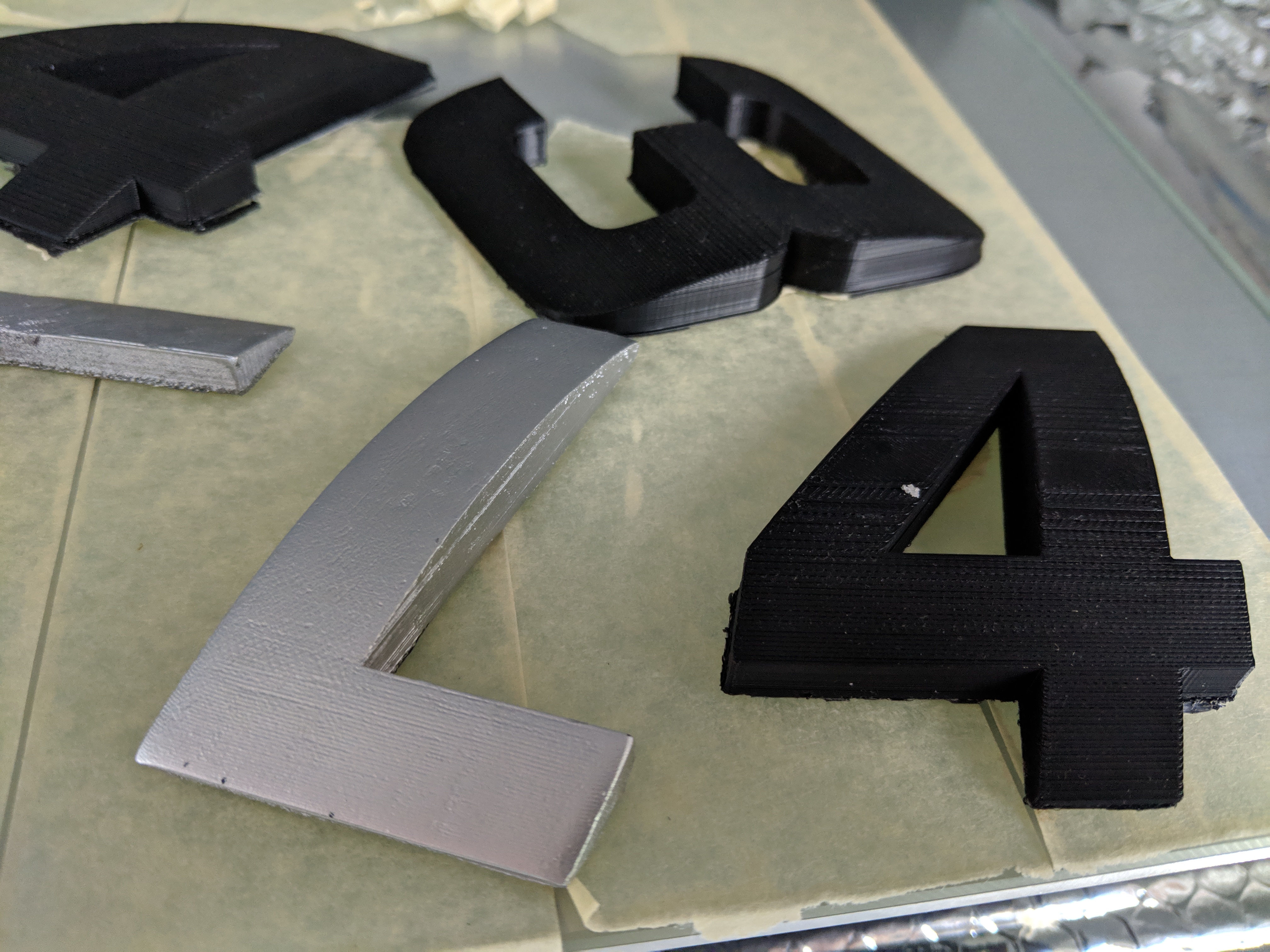

Looks like I chimed in on this 6 years ago. I did a test run of creating 3d letters with a CR10 chinese machine last year. I also ended up with some nice letters but the process to get them to that point was too intensive. Required a lot of sanding and then paint as well, basically required 12-20 hours of printing to make 10-15 letters. ASA filament will handle UV exposure.
WildWestDesigns
There could be some settings that were playing a part in that as well. Even depends on the brand of filament used, as not all handle well. As far as the sanding the filament.
Out of curiosity, did you go from modeling to print or did you use a slicer program in the process as well? Sometimes that helps spot trouble areas as well or help with the extrusion.

[Edit] as for the sanding. Look at ABS and acetone bath. Lots of youtube videos on it. It uses the fumes of acetone, but it makes the prints come out super smooth. Most printers can't handle ABS without an enclosure and modification, unless you buy a high end printer. But you cut out hour of sanding and post trimming this way. One of the main reasons I went from a $200 DIY printer to a $2500 printer.

These are all ABS, I built an enclosure which worked well. I just think the whole process was going to be too labor intensive to make it a feasible for production. The L is sanded down and painted, you can see it was still not sanded enough.
Modelling done in Fusion 360 then sliced in Simplify3D
