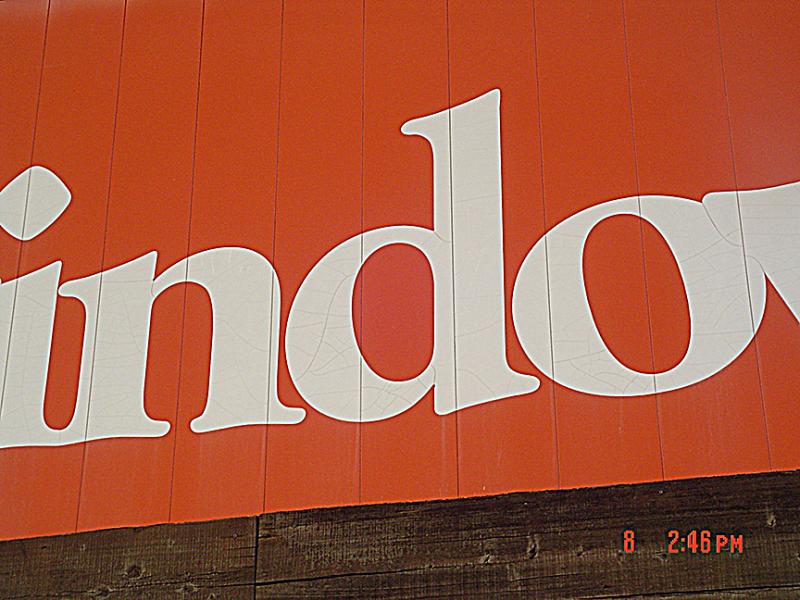

i think seams would not be a big deal on something like this... i have a job to bid redoing a storefront with the attached pic. the total length is about 75-80ft and about 10 ft high but the original substrate is multiple small panels like older billboards and no one even notices.
