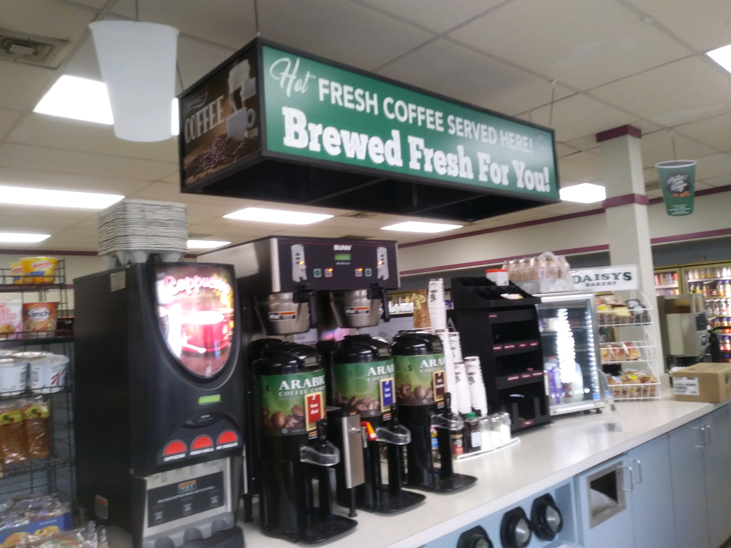

we are selling a client 4 sided suspended signs
picture a frame 24" x 16" x72" (1x2 pine dado cut to retain sintra panels (it's about the size of a coffin when it is finished)
we are producing them in house, but i could build a house in the time it takes to make 20 of these...
a competitor produced something with a metal frame, (like electrical conduit) and they dry wall screw the panels to the frame
not as nice finish quality, as ours...
client loves ours, but after the first run, we are having trouble adapting it to mass production
so, suggestion for a supplier for extruded metal frames, or simply a fitting that would allow me to build these out of conduit?
(a 3/4" elbow with an additional fitting pointing straight up, at a 90 degree angle, if you get my drift

Would the client go for a dye sub fabric sign?
Another option would be to have a cabinet shop make your "sticks". They are set up for production. Then all you have to do is assemble.
Couple simple fixtures and Robert is your sisters brother.
Or you could look into 80/20 extrusions.
Honestly though if the client is stoked because they're getting a quality product I would keep giving them what they want.
I don't know the name of the company anymore but they make corner pieces with top spaces for extenders out of white, black and clear pvc and all you have to do is insert a gatorboard panel in it. Some kind of glue will make it stay without any effort. I used them years ago making the same kind of structures. I think it was in Florida. I'll look around to see if I can find anymore information.

the client really likes these.
we have the setup to produce them, we have a complete woodworking shop, it's just more labor intensive than i like

our client likes the "finished look" of having a wooden frame around everything. he hates the look of seeing the edge of the sintra (also not a fan of visible lines from coro)

Every time I'm confronted with a project like this I tend to over design it. I'd design a wood frame complete with dados, rabbited joints, and other fanciness. Then, generally after I labor through the first copy, I realize that this thing doesn't have to be a wooden frame with panels neatly dadoed in place, all it has to be is something that looks like a wooden frame with panels neatly dadoed in place. With that mindset more often than not I can figure out a much simpler way to make one. Somestimes I come up with nothing simpler and easier and I have to bite then bullet. But you should try to approach it as an illusionist and not a cabinet maker.

Then if you are doing higher volume and need to scale, contact a local extruder and give them samples of what you need and price out running a batch that will last a quarter or half years time.

20ga aluminum bent into angle, rivet corners and spray flat black. Even tack it together. You could bang that out in no time

I'd use prepainted .040" myself (but that'll leave a raw edge I suppose), or just buy some 1/16" aluminum angle and tack it together, or even just some Lords adhesive.

You could use black 8020 pieces and slide panels into the grooves. They make corner pieces to give it a finished look.
