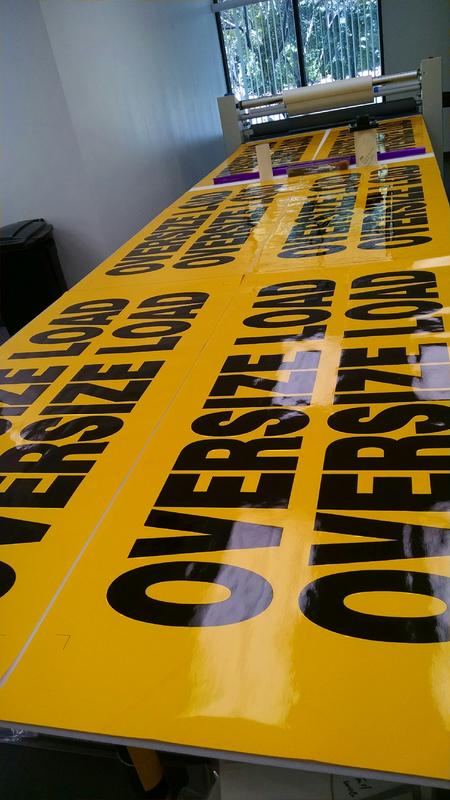

In my opinion you can never have too much work surface. Id build as big as you can. You never know what opportunities will come your way. I built 2 5x10 tables and a 5x8 table. I do alot of large equipment fleet graphics, (cranes, road tractors, truck wraps, etc.).

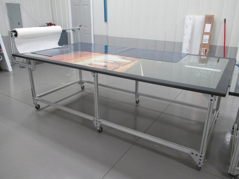

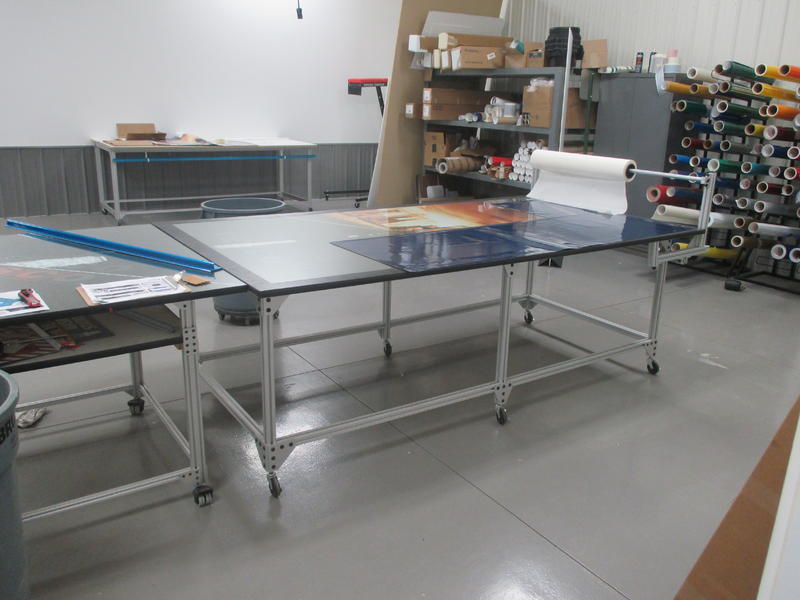

for me my table i made it out of extruded aluminum. put it on some nice whiles and added a premask holder. works perfect for all i have needed it for
I like those, good idea.
What's your tabletop material made out of?
We have ones similar out of angle iron but they don't look anywhere that nice.
The one thing I noticed is you don't have locking wheels, how do you keep them from rolling while taping?

the wheels are locking wheels. not sure if i got those that good in the picture. but the table is made out of aluminum and a plywood base under the glass. for an added flair i put some graphic between the wood and glass. used some plastic strips to line around the glass and a rubber bumper edge holding it all together.
i normally only keep 30" premask loaded since it works the best for me and easiest for a single person to use than a wider roll
