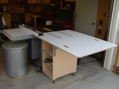

I'm in the middle of a huge project and have had a need to cut down a lot of plywood ranging in thickness from 3/8" to 3/4" on my table saw. I'm not as young and spry as I once was and moving 30 sheets of plywood through a fence is a bit exhausting especially when I'm by myself. With the heaviest pieces around 50lbs and awkward I've been looking at different options for moving substrates particularly to and through a table saw.
A couple of options that I've been eyeing up or a combination of all would be an infeed and outfeed table.
attachment.php

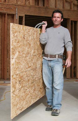

Of course there's the Gorilla gripper :
attachment.php

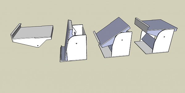

A plywood cart.
attachment.php
This one is freakin' brilliant.... And watch the video http://ezsmart.blogspot.com/2008/08/plywood-cart.html
Its a cart that can tilt up horizontal and double as an infeed table. Also the bed itself is a torsion box (think perfect flatness for furniture assembly)

I used a hydraulic lift table located at the feed side of the table saw...was just close enough to slide a sheet over onto the table...
If you don't want to invest in the table idea, use your fork lift.
Off feed table is a absolute must, stationary. Bigger is better.

I think you're best bet would be to figure out exactly what you want to cut, in what order and how many of various sizes. Call on someone to come in and help you for a day. Even with the gorilla grips, you still have a lot of bending, hoisting up and futzing around with big clumsy panels. There's nothing like a second pair of hands.... not to mention, they can be doing things while you're doing other things.

That thing is pretty sweet weaselboogie. The one in the video looks like it has a smaller footprint so when it's time to store away it doesn't take up a lot of room.
Is this something you plan on making yourself? If it is can you keep us posted?
