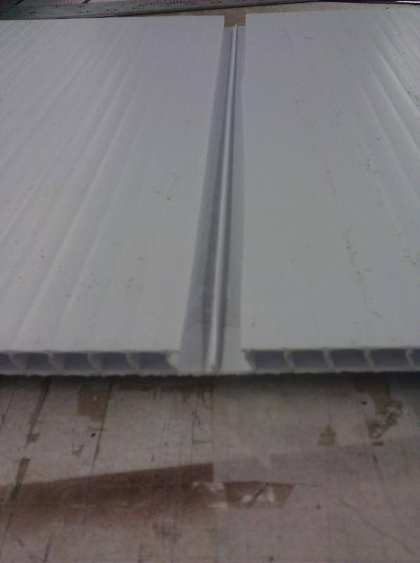

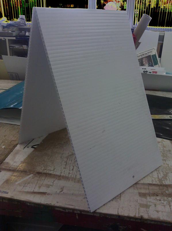

Cheap and quick....as long as your signs aren't more than 24" tall
Use 1/2" coro, cut the width you want making sure the flutes run horizontally. If you want your face to be 24" x 24" then you'd cut a 24" x 48" piece.
Use a coro-cutter to remove the material from one side of the flute in the center so you can fold it over.
Drill a hole in the bottoms, tie a rope between them to keep if from opening up.
You can get 4 out of a sheet, 20 of them would only take about an hour to make, they still fold like an a-frame and they last for years.

I am sorry did you say to cut out one of the flutes or just cut down the flute? I see the picture but do not quite get it?
Pat Whatley
I usually cut two adjoining flutes, bend the material over and cut out the exposed rib. It leaves about a 1/2" wide gap (what you see there) so it folds over cleanly.
