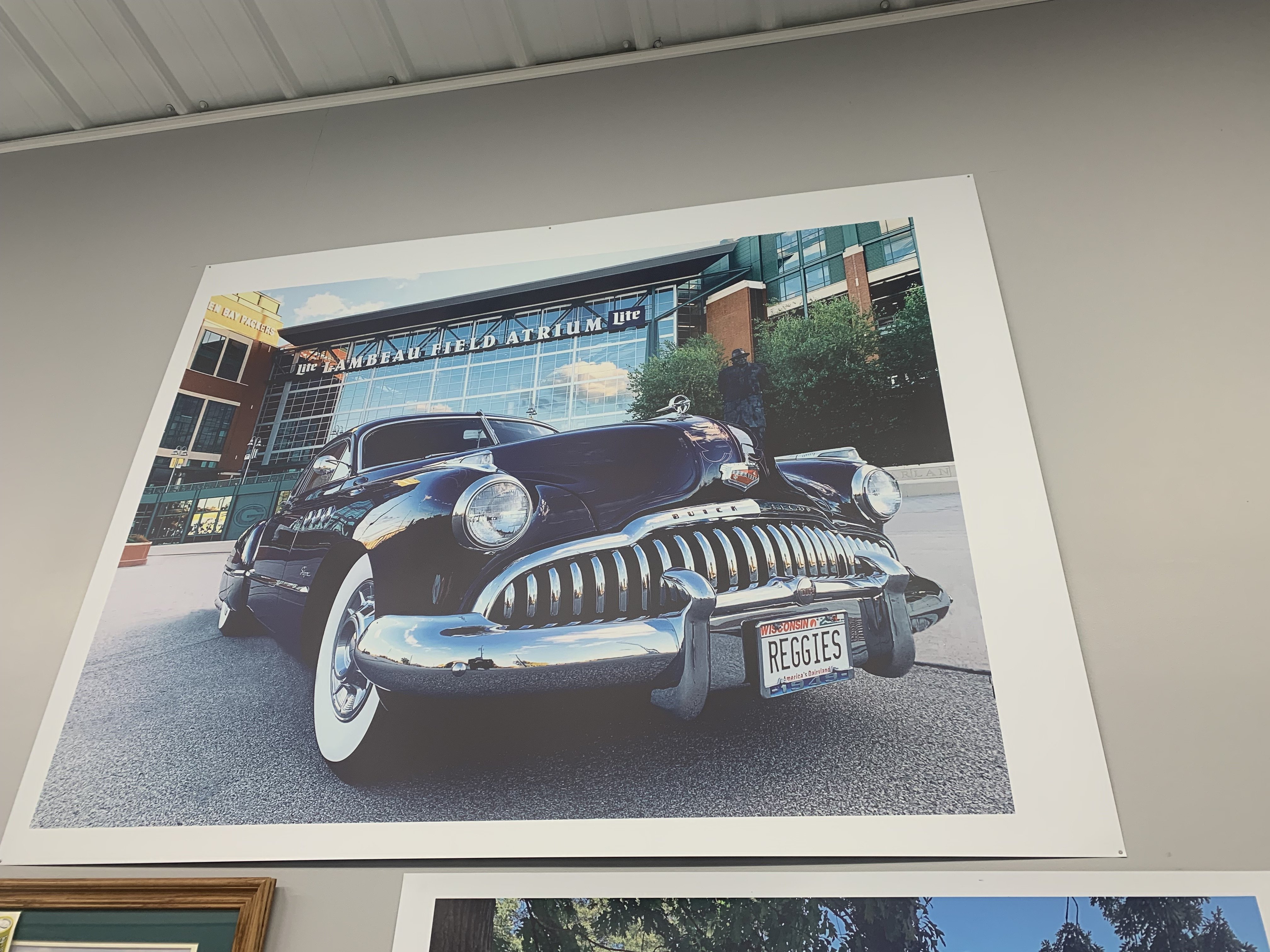

I had a customer that did not want the banner look so my rep turned me onto some stuff called
pop-up I think it is the same stuff mentioned above that is smooth and curl free (which it still curls a little) but looks real nice and smooth, its not a pure white though but looks real nice and will not rip. I print pictures for car guys to put in the garage that they can just wipe down the picture if it gets dusty or dirty works good looks nice.
