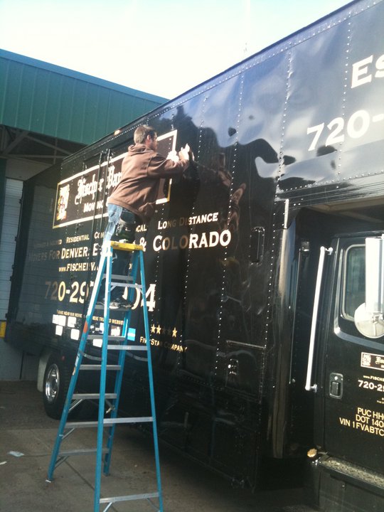

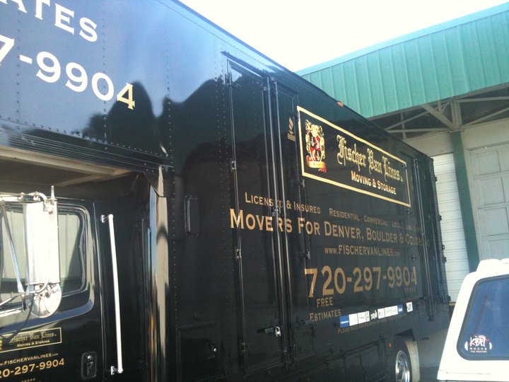

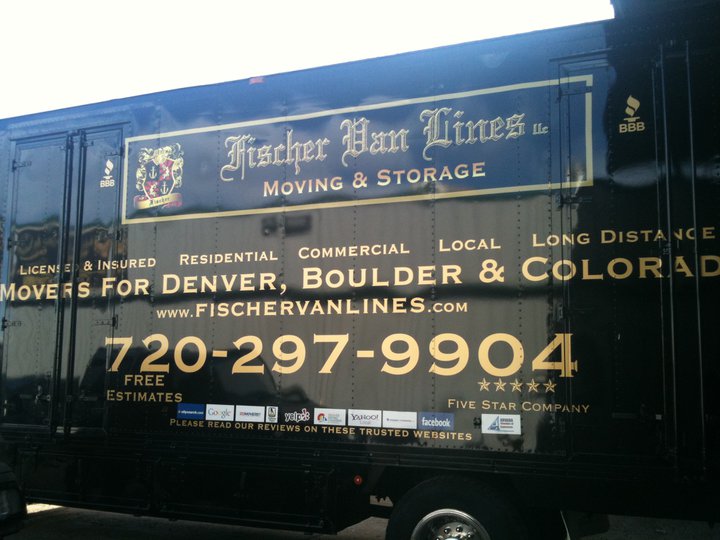

This was the most obnoxious job. Poles, rivets, hinges, doors..20 degrees it was terrible.
It's a 38 ft straight truck. the largest in CO
EDIT: THIS METALLIC GOLD LETTERING AND IJ180 LOGOS APPLIED TO A RIVETED STRAIGHT BOX TRUCK

Clean design...:thumb: is that gold vinyl lettering with the logo as big decal..or did you fully wrap that the the cab and all?? Just curious if truck was a weird color and black & gold are there colors

am i the only person not really liking the design? app looks great...i wouldn't suggest doing any application in 20 degree weather, but everything looks like it went down nicely.
HulkSmash
how did you overcome the temperature issue?
Those are myths! Myths i say! We have a 5k sq garage. we just couldn't fit it because of the height. Garage door 14.5 feet... Vehicle height.. 14.7 feet..
We had to be really careful heating the rivets... and pushing down the lettering if we pushed too hard because it was cold it would split.. Needless to say we had several "re cuts" on certain gold lettering letters.
But we've done Dozens of installs outside - the temperature isn't as big as an issue as most make it out to be for installing vinyl IMHO.

With the sun shining on it, the substrate surface temp is acceptable. been there.

Yeah, they didn't want to pay 11k to wrap the whole thing. So they paid 1k at maco to have it sprayed, and i lettered it. and put the logo on in Control Tac.

For the rectangle logo - IJ180 w/ 8518 OL.
For the Gold lettering - Avery Ultimate Cast 900 Metallic Gold.. (worked surprisingly well over rivets)
