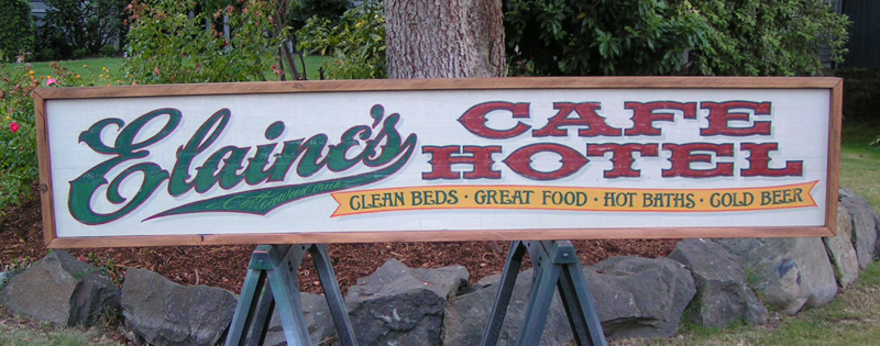

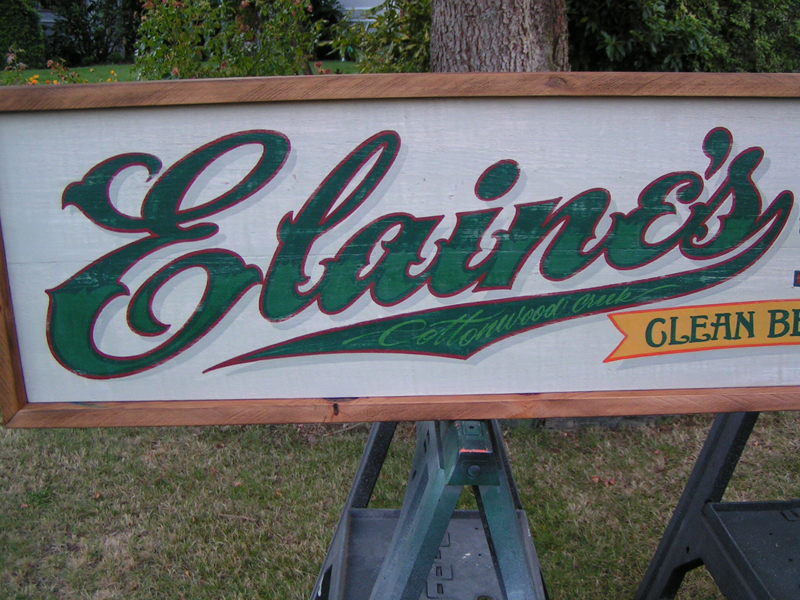

This is another "Antiqued" or "weathered" looking piece to add to the ranch decor. Hand lettered on rough cedar with Ronan's Japan Colors. I wanted it to look somewhat old and lettered in a rough manner. The fonts used are a variation of LHF Fancy Full Spurs Bold, Grant Antique and A&S Tuscano Script (not yet released).

Super nice !!
Did you do any of that wet on wet ??
Other than prepping the background and stuff.... just lettering time.... about 5 or so hours ??

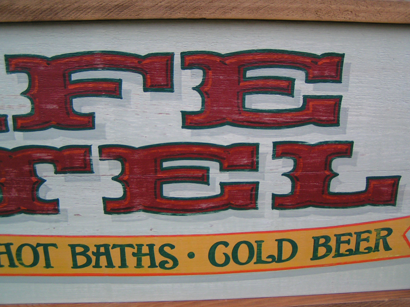

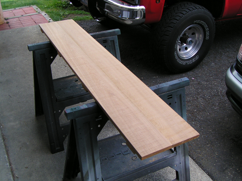

No wet on wet. Japan Colors dry very fast, much like poster colors. Lettering time was about 4 hrs. Pretty much a slam. All total from first saw cut to finished frame was about 8 hrs. I didn't have any cedar wide enough for a one piece plank so I used two pieces put together.

Painting rough cedar is not easy. Did you use a fitch.
Excellent Brush Work! :thumb:
All Quill work. The sign is only 10-3/4" x 60"
The order of color application was...
* Green base on Elaine's
* Red/Brown base on Cafe/Hotel
* Yellow base on ribbon
* shadows on all
* outlines on Elaine's, then on Cafe/Hotel
* Ribbon copy/text
* lighter inside green on Elaine's
* Highlights & Accents on Cafe/Hotel
* outline on ribbon

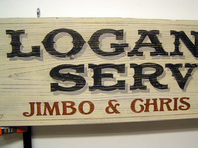

do you sand after the paint is dry to get a more weathered look?
Yes. After an off-white base primer, then again after a tinted base finish coat and then lightly after the lettering is dry and then followed up with a Scotchbright pad.
This was a brushed on background.
Depending on the wood grain and how much weather exposure the piece of wood I choose has, I'll sometimes brush coat and then buff the paint into the wood two or three coats and finish off with just Scotchbrite after lettering for a different look. Like this one...
