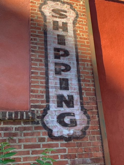

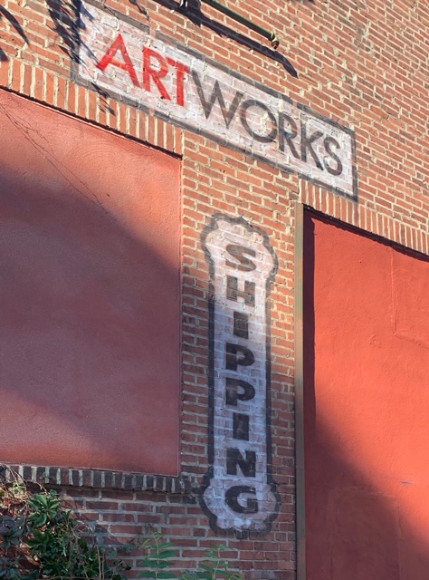

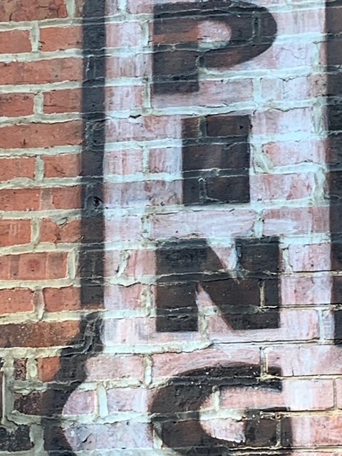

We still do this but not in the traditional way of mopping paint. We cut acm spray stencils on the router.
Here is a recent one. It was supposed to look like an old faded wall sign.
We used black, white and red krylon from Homers depot. Scuffed that up with wire wheel on a grinder. Then smeared a nice clearcoat on top.
If it had to look new we would use the same technique but lay down more paint.

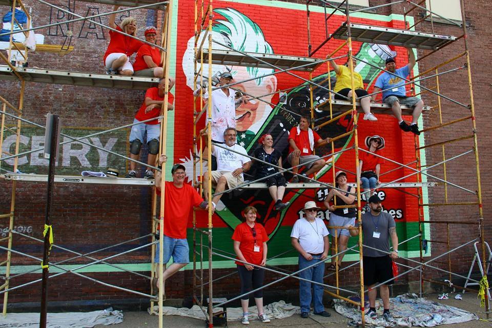

His name was Craig Solquest or something like that from Orlando and rode a bike.
Craig Sjoquist, Lives in Fairvilla FL, actually, originally from Minnesota, hence the Scandinavian name. I've worked on a couple walls with him. Competent, old school.
Craig is the guy in the lab coat standing on the pick, middle of the picture. I'm the fat one standing on the ground in the white T-shirt. The wall was design by Jill Welsh, in black with the red bandana.
You can find him on Facebook. I don't have his number.
