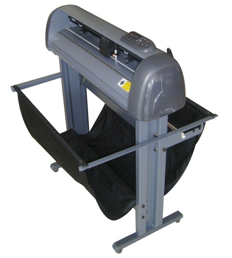

I have a small 24" cutter and I was wondering if I can add a media basket. Anybody made one themselves? Maybe links to some cheap ones out there? BTW, what fabric best to use? Do I need a fabric, maybe just simple backing paper.
I jsut dont want my vinyl to get dirty on some of the longer stuff I cut. Just looking for some ideas
I figure I can make something like you see below with some brackets from HD.

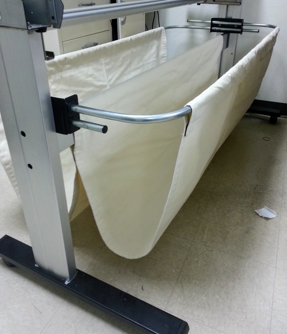

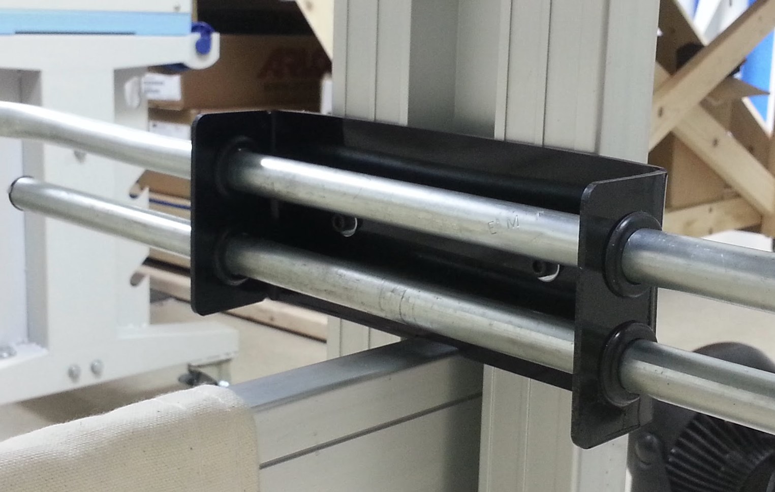

This is what I made for my Graphtec plotter about 9 years ago:
- metal conduit (shaped with pipe bender), rubber grommets / end caps from Lowe's
- custom plastic bracket (black engraved acrylic + heat gun for bending)
- a few yards of fabric from Hobby Lobby, stitched on my sewing machine (w/ velcro)

Thanks for this, I need to build a couple for the shop! I tried using pvc pipes in the past and they just didn't have the strength. I like your design much better, looks solid.
tulsagraphics
Thanks! I modeled it from Graphtec's older designs. Quick tip: If you use the same materials I did... maybe do away with the rubber grommets so the rods will slide in/out more easily. Mine were a little snug so I had to keep them greased.
Good to know, thanks for the tip!
