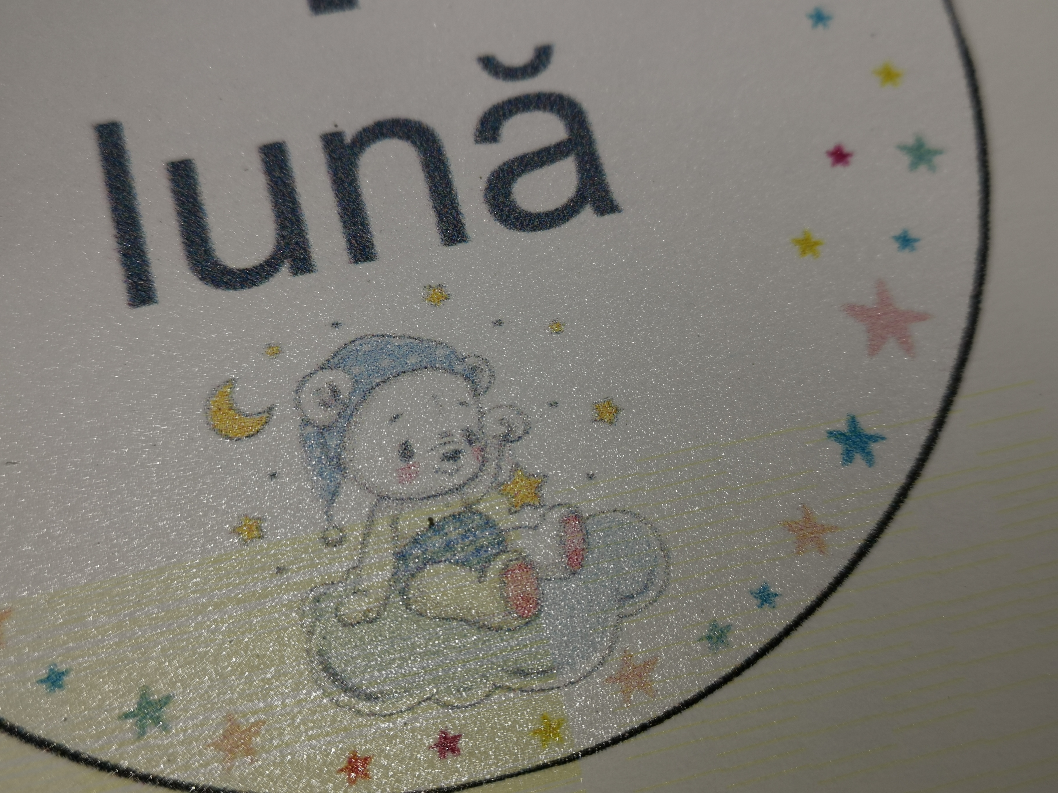

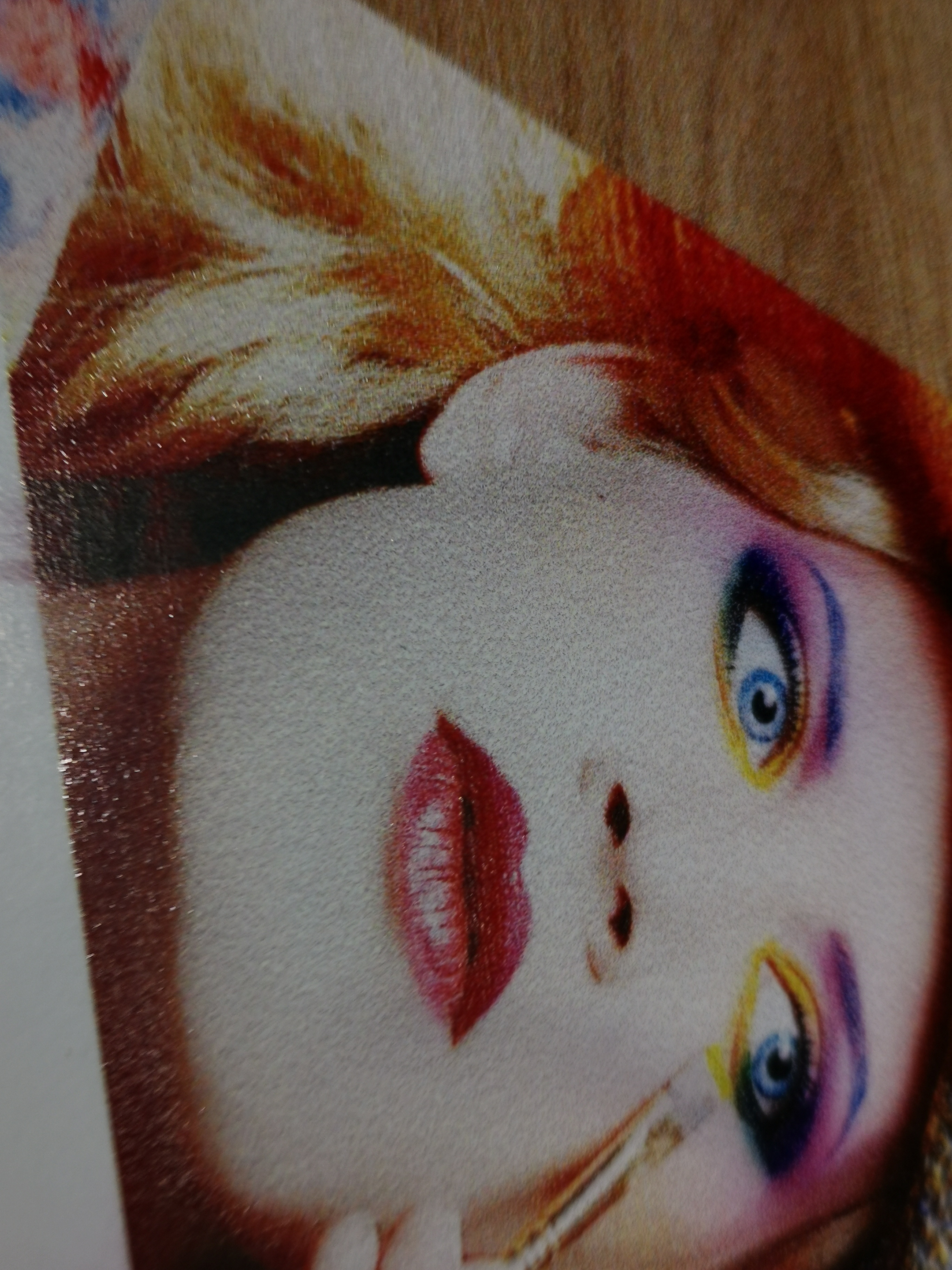

Look. This is my problem. I did what you told me with points alignment, but still no great resolution. The points are spreads.
Any other idea what could be?
growler
What's your rip/print settings, what happens if you print in UNI directional, do you get a better quality or is it the same?
Possibly a height issue, what did you measure and what did you set the height as?
