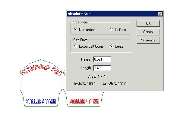

I did find a way (without turning off auto-fill) to change one straight line's length at a time. By going to Shape in the toolbar, absolute size and selecting non-uniform and center, you can change the length of the line, but not the height. however... it's for the block, not the text, so when you try it on a curved line, your curve changes diameter if you know what I mean (this is an oh-darn situation it seems). The second part of my question was if I wanted to change more than one of those blocks at a time, could I have it change the length on each shape's center, not all of them combined... If that makes ANY more sense :p

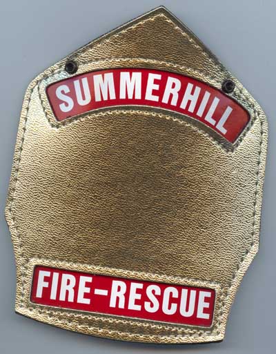

Surely! There's a pic of what we're making, and my trixy straight line still in auto-fill method of changing shapes. i think the answer to "can i do them on their own centers" is no. i have to do it to each individual one (which is also ok)... if only i could figure out the magic way to do the arc line on top...
I notice that on the toolbar is a pulldown for "text" but any kind of action is greyed out... is that normal and would anything in that pulldown potentially help me here? I can't get it to ungrey even when i DON'T use autofill

i don't think you'll be able to do that....because it would mean calculating the diameter of the circle/arc for the text to fit on.....
