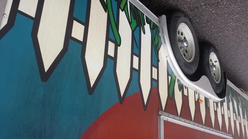

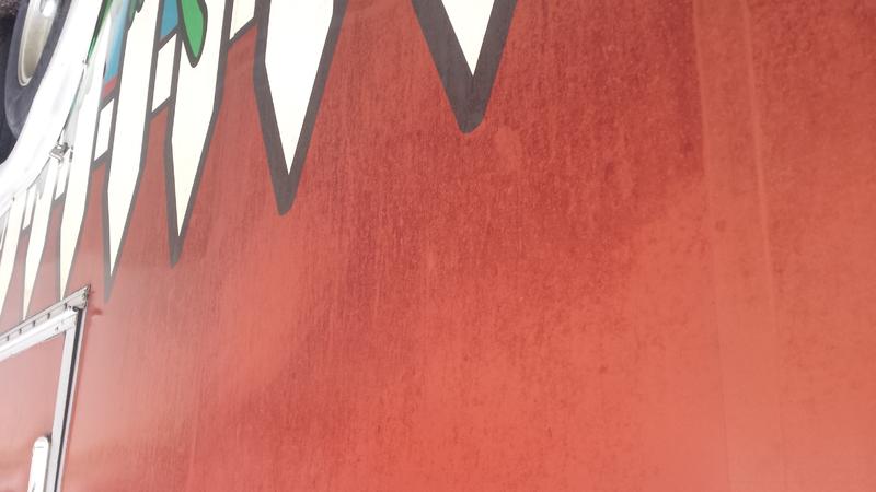

I was a fool for giving them a try 2 years ago. We used Avery for about 2-3 months because of some disagreements with 3M. THANK GOD we stopped using because of CONSTANT contaminated rolls.
We used their new vinyl - now everything done in Avery 1.5 years later looks like it has caught on fire. I mean I literally did a fleet of 6 vehicles, 2 done in Avery 4 in 3M. the 2 Avery ones are literally cracked, brown, and just disgusting. the 3M looks pretty much like the day we installed it. Lucky for us we didn't do hundreds of vehicles with it, just a few dozen.
And in December we had to do a fleet spec'd in Avery SW Blue. Good God. It was literally the most garbage material ever. I had to spend $250 on surgical scalpels because nothing else would cut it without it stretching and causing jagged cuts. The material is literal Garbage.
Anyone using the "New and improved" Avery wrap vinyl do yourself a favor and stop before it destroys your business and reputation. I have claims in, let's see if avery steps up this time - for their sake i really hope they do.
Everyone here knows i can really start a movement. And I'm pretty pissed off.
Attached are examples of Avery failures.

I've beaten my vendors up enough that my 3M pricing isn't a huge difference in avery. Avery is cool to install, but sadly their product is not built to last... at least in Colorado where we are a mile high, and have extreme hot summers and extreme cold winters.
I've had an avery rep come in my shop and tell me that wasn't an issue. Take my word on this sightline - run very far away.

We've had a couple of rolls returned with what looks like plasticiser migration.
Got refunded. But then we had issues with rolls of 3M 480 too.

:popcorn: I'm going to keep my eye on this post. I've been 85% Avery 15% 3M for years now. I did see one of our wraps around that were still young that looked like that.
Thought maybe it was them not taking care of it.
