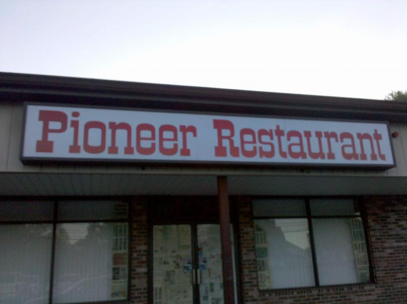

Hey guys, in another post i mentioned the job coming up tomorrow for a customer who wants the old sign taken down and new one up.
Here is the sign box i'm talking about, I'm thinking now i may try to install the face myself with a friend or two but how does a back lit face come out?
Also, the total size is 18ftx2.5ft, any idea why the other company made a split between the T and A?

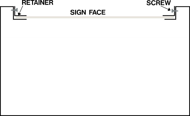

The face comes out whatever way it went in....just had to say it, but it's true. That looks like a drop in box. The face is held in by an L shaped aluminum trim (the retainer) which is scewed (usually with self tap hex heads) to the box.
The seam is there because (maybe)they used a 5'x12' piece of lexan to make the face. In any case you'll have a seam somewhere unless you use a flex face.When doing a seamed face we rout an overlap at the seam so you don't see the light line. And try to get the seam to fall between the letters if possible.

Not the whole thing. The retainer is usually made in several sections around the perimeter.
Billct2
Then again if it's a Sign Comp type with "hinge face" you will have to take the whole face & frame down.

Here is another view i have of the sign box
Also, what do you mean you route something for the seam, You put the 2 pieces together, then what?

Billct2
Slide in face, take one end off and face slide out.
We rout an overlap where the two pieces butt together so there isn't a seam where the light will shine thru.

What you need to do is remove the face by sliding it out sideways, or if the sign face is hinged remove the frame and hinge together. Don't re-use the old face. If it's been there some time the face will have a ghost image of it's graphic. If you have to re-use it turn it upside down, this makes the ghost text unreadable or harder to see. Best to get new material. The best material is lexan, it's almost bomb proof. Don't seam in a material lexan comes in whatever length you will need. The wholesaler will sell it off a roll in different widths. Always buy a couple feet more than you need, in case the cuts aren't square. Cut the material with a skill saw with a plywood or non-ferrous metal blade. The one you took out may have had tabs on the edge of it. Purchase glue for the lexan material and build new tabs from your scrap material. Build them exactly like the one you removed. Put it up in reverse of the way you removed it. Hope this helps some.
andy
+1 on sliding the panels out sideways.
DO NOT take out all the screws along the top beading... the bead will come off and the panels will tip forward... right onto the pavement.
At the depth you are quoting the panels should have strips of acrylic bonded along the top edge... either on the front or back of the panel. These are your hanging rails which take up expansion and contraction... for a sign like this the panels are usually cut slightly smaller than the metal box and the panel is "hung". This stops the panel warping when it expands on a hot day.
For replacement panels my choice would be 5mm thick Opal 050 acrylic. This will give you nice flat panels which are easy to letter and easy to slide back in. At the size you need this would require two panels with a single join.
Whatever material you decide to use get them cut to the same size as the old panels you're taking out... this makes sure everything will fit back together.
