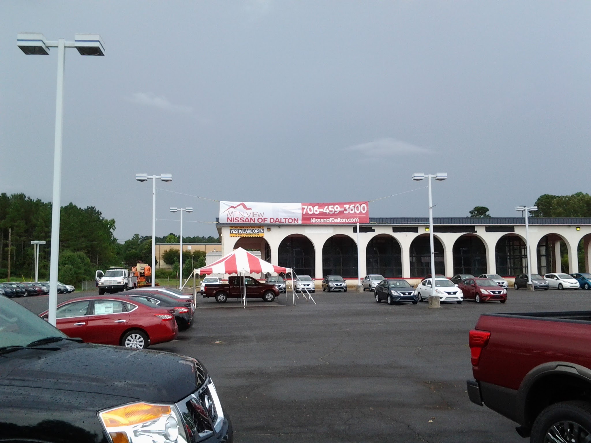

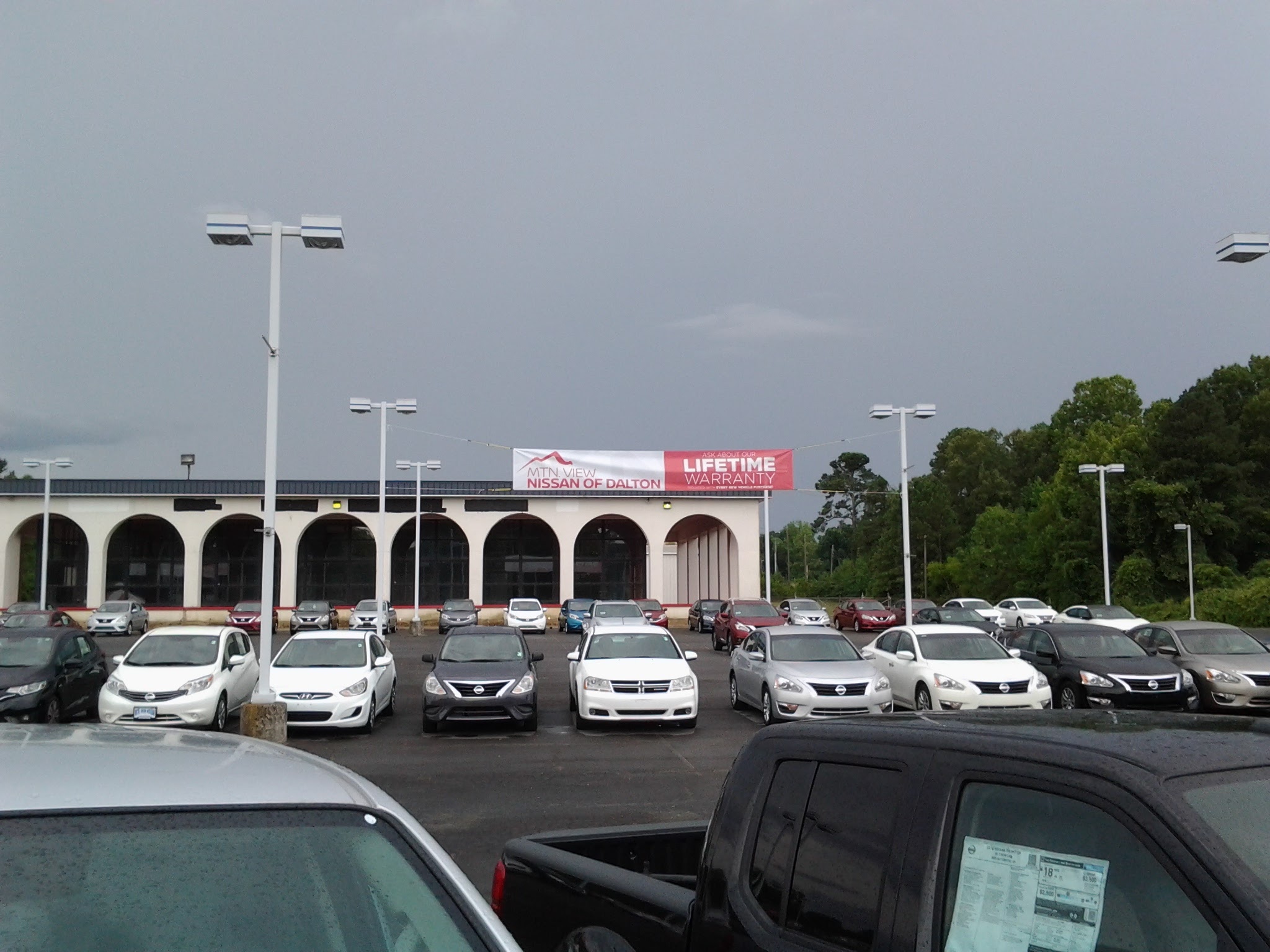

Here are (2) 27ft x 4ft mesh banner which have been up for several months and still look the same. These were made by signs365 with rope in the hem. We used heavy bungee cords for attachment to the poles.

Nice example ThatGuy, but you can see you have a big sag in both of yours. The OP's banner is almost twice as long as yours and will have more sag than yours just due to the weight, let alone tension slowly leaving in a bungee.

We found the rope/bungee combo was sufficient for this install. I would agree that any larger and a cable system would be required. These have been up for over 6 months and still look the same.
As to the quality of the 365 banners, I have seen a few threads on here giving their quality a thumbs down but I personally have not had any negative issues. I did have a banner shipped without rope once but I took a picture of it and they shipped me a replacement immediately.
