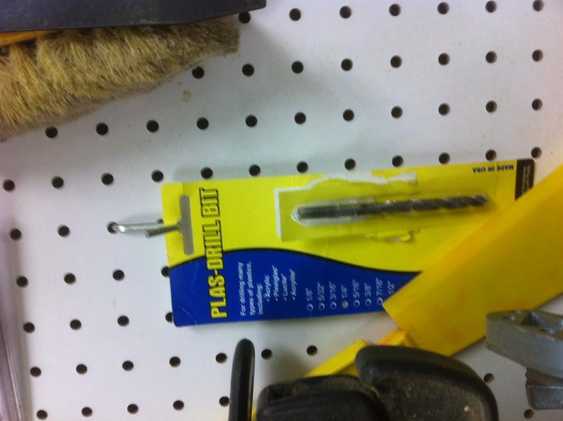

I would wager to say most of the folks in this thread that have posted or are interested in the subject, drill holes in 1/4" or 3/8" acrylic. That's the typical application I need the bits for. I use the Harbor Freight one in the attached photo on the right. It will drill through 1/4" acrylic because the steps are 1/4". If I have to drill in thicker material, I can still use this bit...as soon as the smallest portion of the bit exits the back of the material, I finish the hole by drilling from the back. In the rare and odd event I have to drill something thicker, I use a regular bit and take my time. I've drilled hundreds of holes in acrylic with these bits. I worked at a national sign company and they used these bits. But even if it works for a national sign company cranking out millions of dollars of signs every year, I guess if you say it's not "proper", well everybody better run out and buy acrylic bits. I'll swing by the sign company and let them know they've been doing it wrong all of these years.
