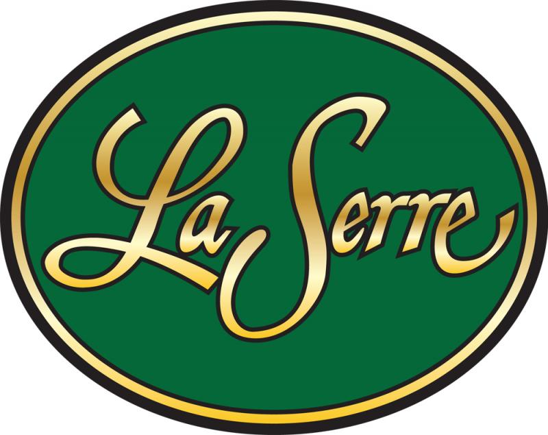

Here is the design for the sign. I think we will end up painting in the gold. The sign will be 60"x48" 1/2" lusterboard. Would I be best off rolling on the gold paint to the white substrate, then apply black and green vinyl on top?

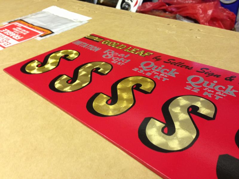

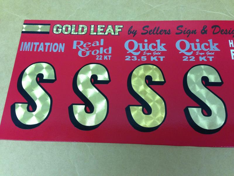

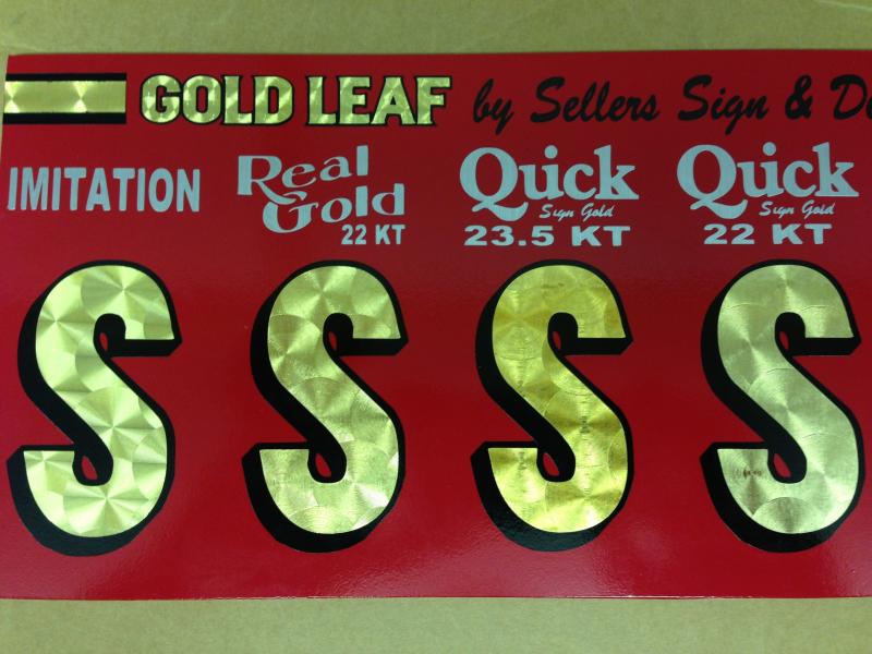

I ordered samples of the Sign Gold 22 kt and 23.5 kt, as well as the Real Gold engine turn vinyl. I cut the same "S" out of each one and also some imitation gold leaf vinyl and put them side by side on a sign so I could compare. The 23.5 kt Sign Gold is really nice, and can be applied to the reverse side of a window. But it it's pricey. I really think the Real Gold brand is the closest match to hand gilded gold leaf, and the price is the same as the 22 kt Sign Gold. If anyone is interested I can put up a picture of the little sign I made so you can compare the different options.

Doesn't Lustreboard come in a dark green color?
I'd opt for the SignGold, use the Florentine to hide the piecing.
Engine Turned has a certain grain and if you piece that, the difference will show.
I had good luck with the Oraleaf stuff but it costs as much as SignGold.
I personally would just gild it.
Lay down your mask, (cut a small contour around everything but don't weed that part) apply your size, weed the contour so your size doesn't get a "lip" wait until it's the right tack, then the gold, remove the mask, then paint the black outline.
Nothing looks like real gold and for the effect you want versus the maybe not-so-long lastingness of the cheaper stuff...
Can you change the font to something nicer or is their logo set in stone?
Here are some pictures of the different vinyl gold leaf options. If you need close ups of any of them I have pictures of that too.
