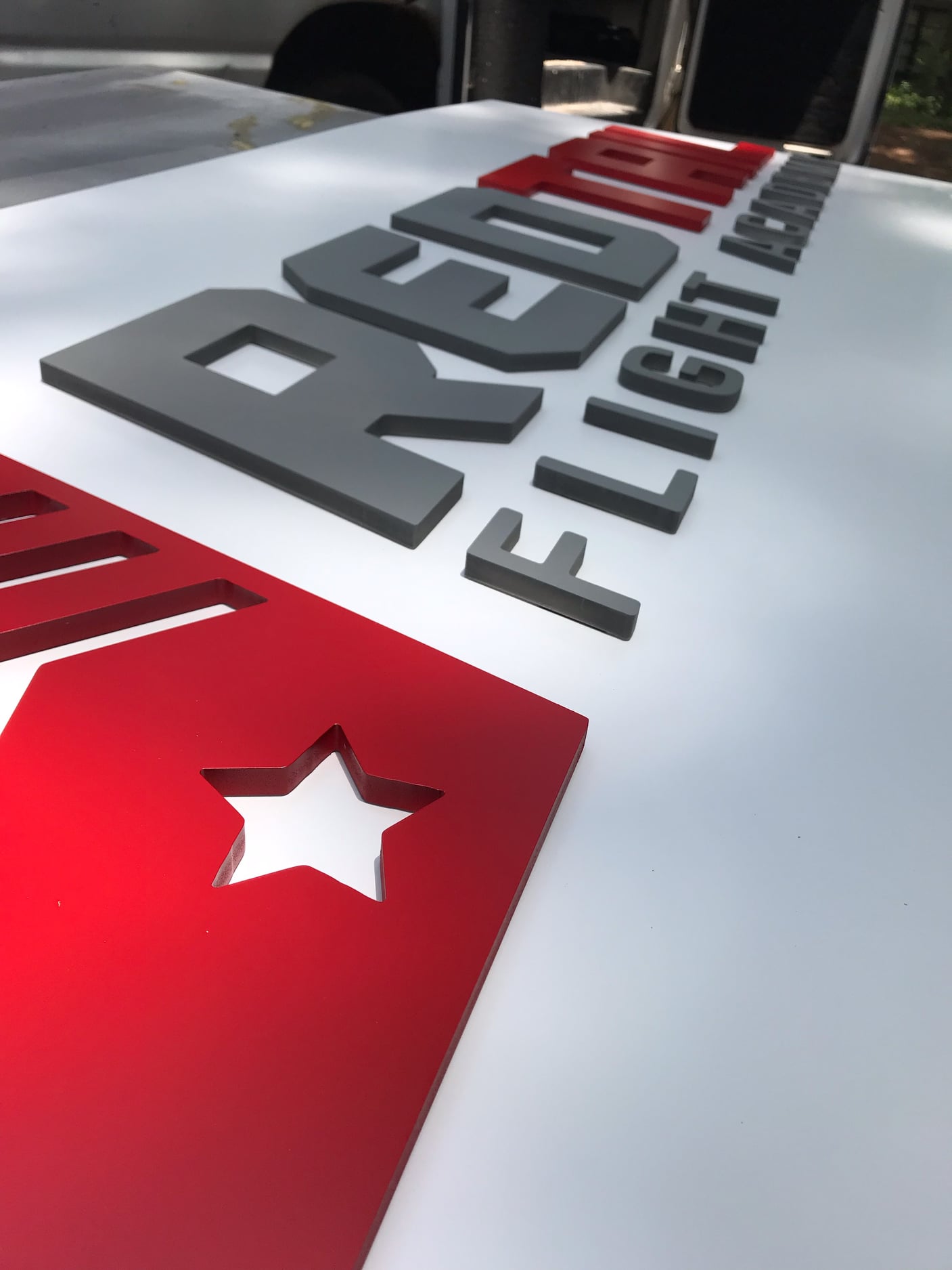

you cant go wrong with aluminum and dimesional pvc letters. adding a 1" frame behind it adds more ooomph
