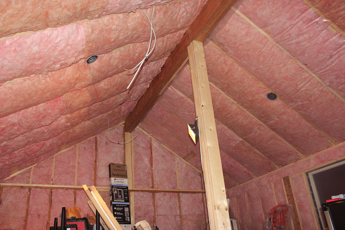

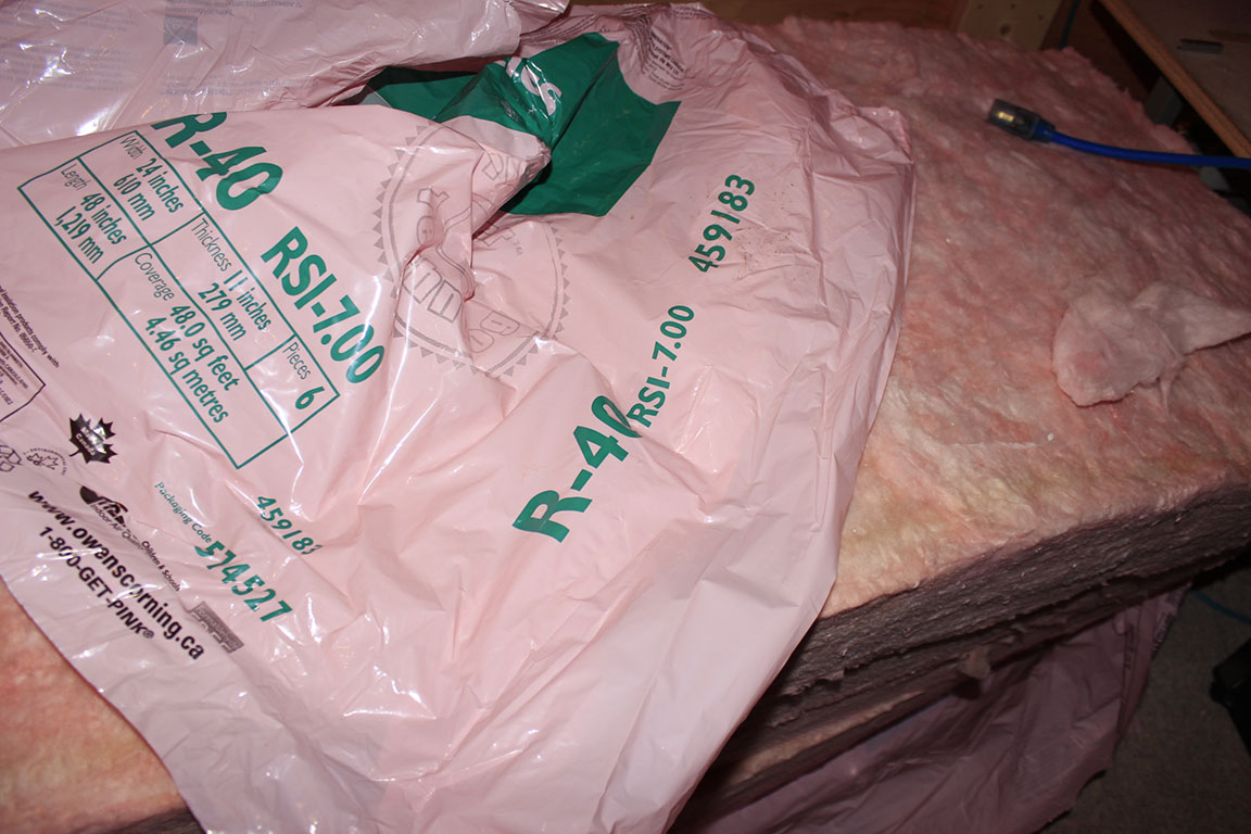

Am a small operator, built a new little studio this winter and went with 6" walls, vaulted ceiling and heavy duty insulation. Two computers running constantly just about keeps it comfortable in cooler temps. No regrets.
