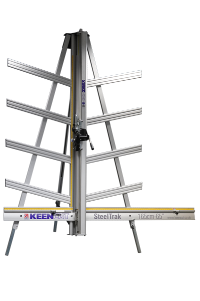

Steeltrak is pretty nice but you will still end up with a lot of manual labor if you are cutting it to many small pieces.
I don't see how you can speed it up much without a flatbed cutter.
https://www.keencut.com/product/steeltrak/

As an interim I'd go for the SteelTrak 250, with some spare production stops and a left hand extension. Fast quick (ish) and clean, with a relatively small footprint. Gives you the option of cutting other materials like PVC, without generating dust. Once volume of work picks up, then a flatbed. You'll likely get over 50% back in resale value, or just keep it for doing other things.

Down side of the Javelin is when you want to cut an 8x4 down to a 4x4 - need really long arms. Also it doen't have the inbuilt squaring of the steeltrak, but it is really high precision cutting. I reckon that I can get within 1mm on the steeltrak, half that on the bench cutter (have Very picky customers...).
And the sound is pretty subtle, unless I'm really pi55ed off, in which case the Dead Kennedys are playing loud, and no-one can hear.

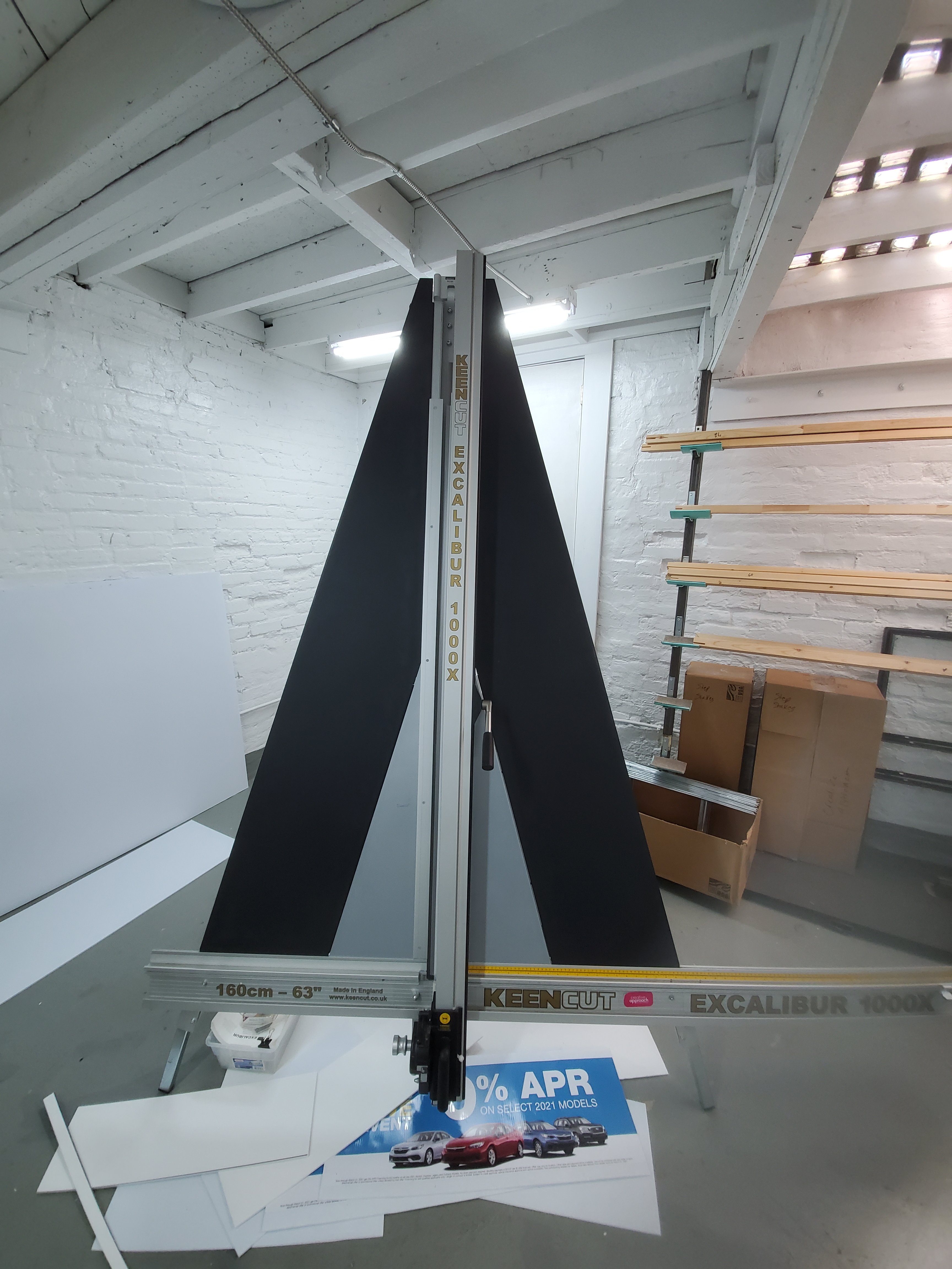

Late to the game, we have Two KeenCut Excalibur 1000s. Works well once you get them calibrated out. Can also do glass.

Amazing edge cuts if you pay attention to the blade. Probably 100 cuts a side per blade so about 200 cuts a blade. Tall edge is close to 65" but don't quote me.

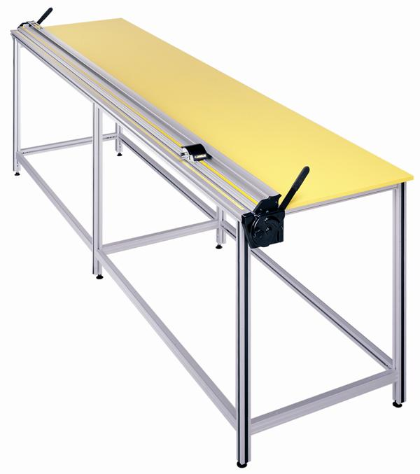

We did have a manual table cutter at one place & it worked great, don't remember the brand, but it looked just like this;
That looks very much like a Keencut BigBench with an old style Javelin cutter. Very precise.
I keep meaning to get a new top for ours with T-slots cut perpindicular to the cutting bar.

That's like a baby SteelTrak, perhaps without the ACM cutter. The 250cm version will do 8x4's. Those blades are around £20/100. Biggest pain is switching blades - the chasis of the cutter is extruded aluminium, so you can't hang a magenetic spare blade tray on the machine, so you have to step atleast a foot or three to grab a replacement.
