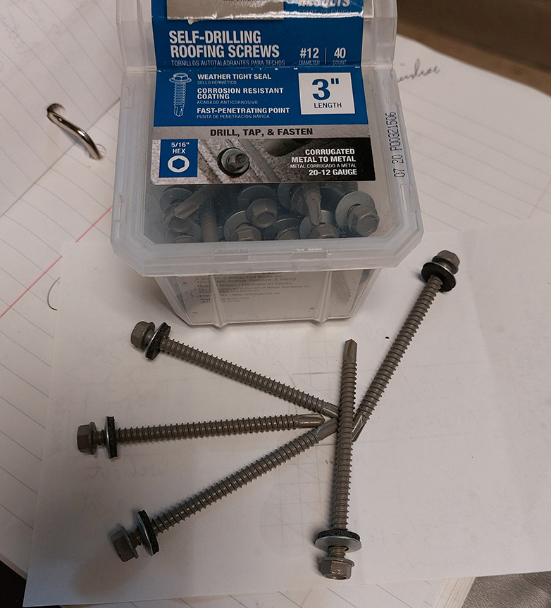

We generally use 2" x 6"s and we almost always run the battens up and down. This doesn't prevent birds or bees nests, but it is much easier to clean behind. We also keep the battens in 2" from top, sides and bottom. We countersink the 2 x 6s for the roofing screws. The top screws are just the lath screws with a flattened head at whatever length we need. They are painted beforehand to match the background.

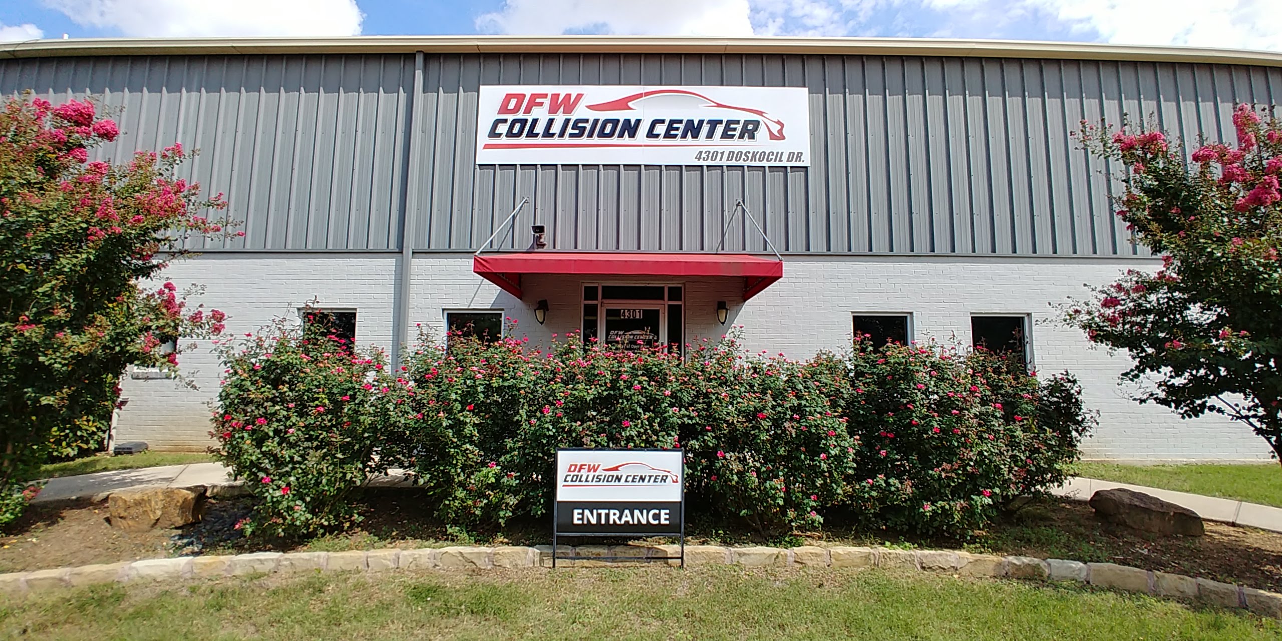

My advice was for a 4x8, which is what the OP asked for. I did these years ago. They're flat and have never leaked.

Nice sign, but if you ran stringers you would have been able to centre this sign instead of trying to get both panels to line up with that one peak in the corrugated.....
It looks silly. If you were going to mount it directly to the building, why didn't you make it a 4x7 or 4x9? The ribs are always 12" OC, they managed to get the awning and the door in the right place but the easiest part of the whole place is 1 foot off center.
I agree but it wasn't my call. There were existing panels that they wanted replaced like-for-like. Same size, same location due to shadowing. I made suggestions and this is what they asked for.
