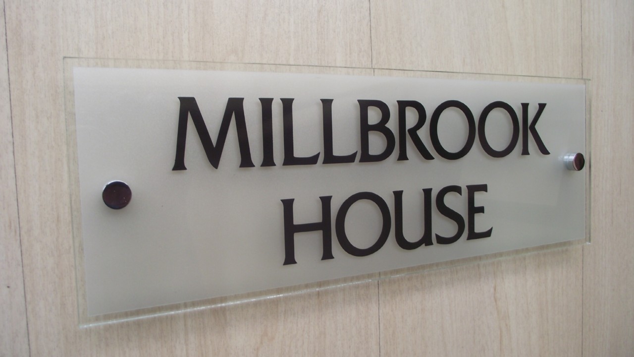

I have a client that is looking to produce something similar to the attached.
The want everything second surface, and NO vinyl. They prefer it all directed printed on 3/16" acrylic.
How would I go about achieving the "dusted glass" look on my FB 750?
Sandblasting it.....will eliminate the lettering which goes down first.
If given all of these restrictions, I would print the copy on the clear and then mask off the outside border and rattlecan a coat of matte clear, but evenly.
It's quite entertaining to have customers who don't know any better tell us how to do our job.
Printing to this and then putting an etch piece down on the back side would be the most cost effective method and the best looking method.
Is there a good reason, why they don't want it produced the same way this one was furnished ??
It appears to be die-cut vinyl front side with etch on the backside, as you can see a slight shadowing effect caused by the vinyl casting it on the etch from the lights above..... or so it appears.
I agree, it should be produced the same as the picture. It will be on a vacation home in Cancun, and want it second surfaced, only ink, for fear of people picking at it.
If that's the only reason.... then just die-cut in reverse, stick it on the backside and put a piece of etch over the back. Bingo you're done and no one can get to the backside and it's a far better product.
Mosh
Print it in reverse on clear, apply that then apply etch film over that, all on the back side (second surface).

I'd also agree. The example shown is not all second surface. You can see the lettering is on the front.
One way though..... cut the lettering in vinyl as a stencil. Apply it, paint the lettering in. Wait for the paint to dry, cut the lettering again this time using the vinyl letters as a mask and apply it perfectly on the painted letters. Then sandblast or acid etch the rest, peel the mask back off.
MikePro
if 2nd surface, should be acceptable to use vinyl. I would print on clear, laminate with etched vinyl, apply 2nd surface.
IF they're hellbent on spending more $$$, then paintmask 2nd surface, black painted lettering, mask again, paint with etched/frosted clear. can get cans of it at any hardware/craft store.
MikePro
noted, you will NOT get that look with everything on 2nd surface. ....there will no longer be that drop shadow-effect from having vinyl on face of plexi, being cast onto the frosted layer 1/4-1/2" behind it.
