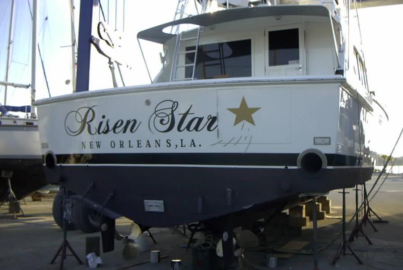

paint on boats ...if your just doin a NAME, just looks so much better and professional. people who own boats.........HAVE MONEY. when you spend $50-100K for a boat, do you really want "stickers" on it???? this is one i did in 99-2001 somewhere in there. i was talkin to someone from new orlens the other day, and they have seen this boat....WITH MY PAINTED letters on it. and yes, the same people owned the kentucky derby winning horse.

Right. Maybe central Alabama is just a complete anomaly but around here most people who name boats don't keep them more than 4-5 years or they're having them redone anyway every 4-5 years. What's the point of painting something on a boat when all that's doing is making it a pain in the ass to change out 5 years later when Bill sells THE LUCKY SPERM to Bob who wants to change the name to WET DREAM?
Paint has it's place.....on the walls of a kitchen for example.

sorry patti, but when your doin, $300,000.00 boat, people aint gona sell it in 5 years. for your beer drinkin, bass fishin guy in alabama, whos boat cost more then his mobile home........i guess stickers are great......he wont have it in 3 years before they repo it!!!!!hahahahahahahaha
