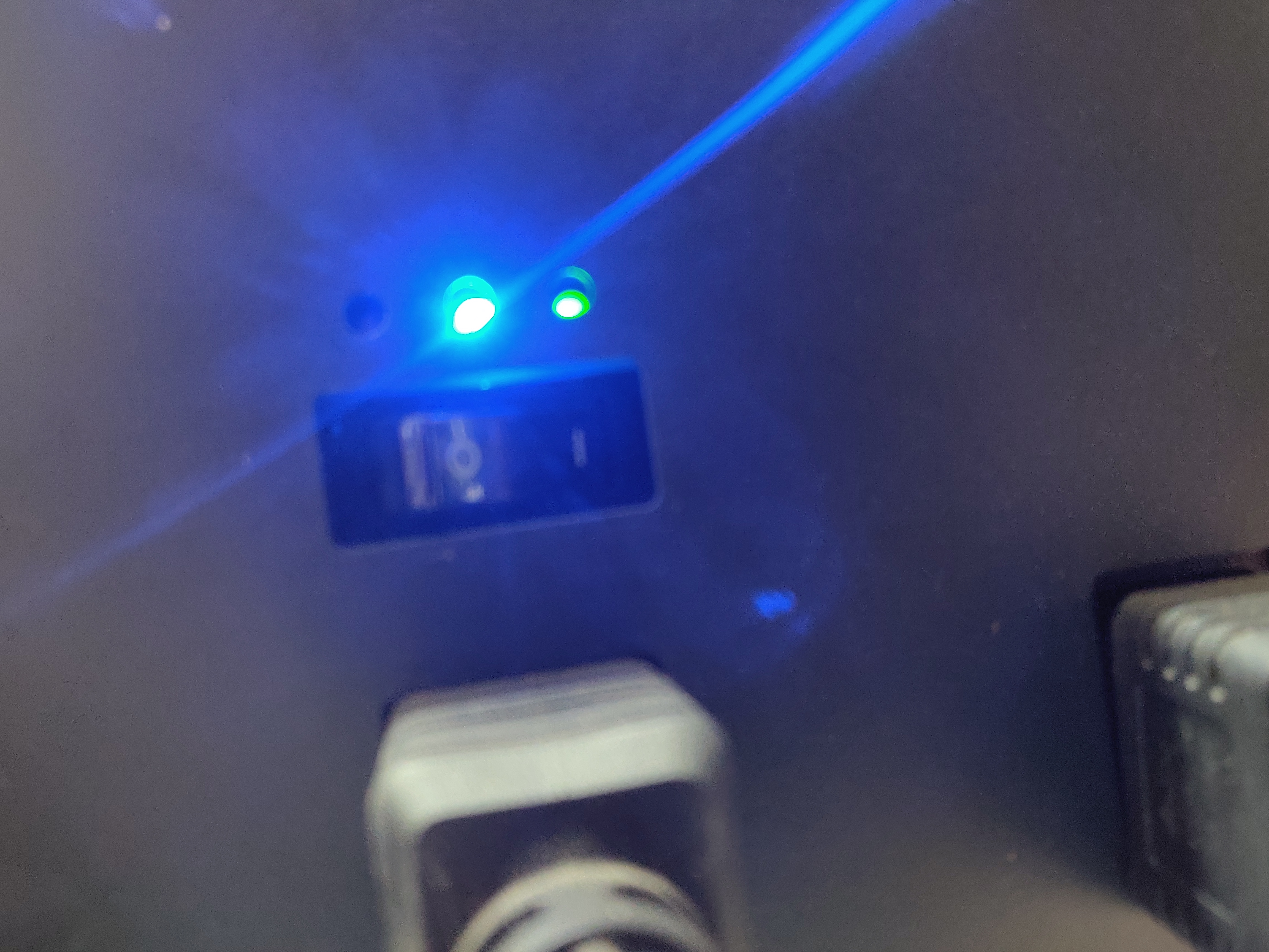

do you see these leds at power switch?.
or are there no leds at all
jimboeejit
ok....so no power getting to the printer panel...
